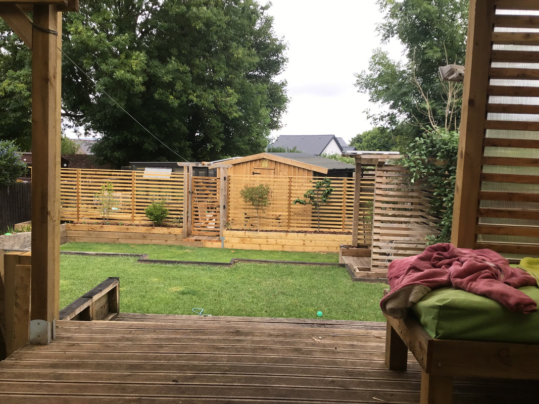

that is brilliant, planning will have a whale of a time for me at least lol@alphaomega16 So as not to keep derailing the other thread.
You just need something like this. Very easy to build.
Toledo – Solar Powered Timber Pergola – Solar Structures Ireland
solarstructures.ie
