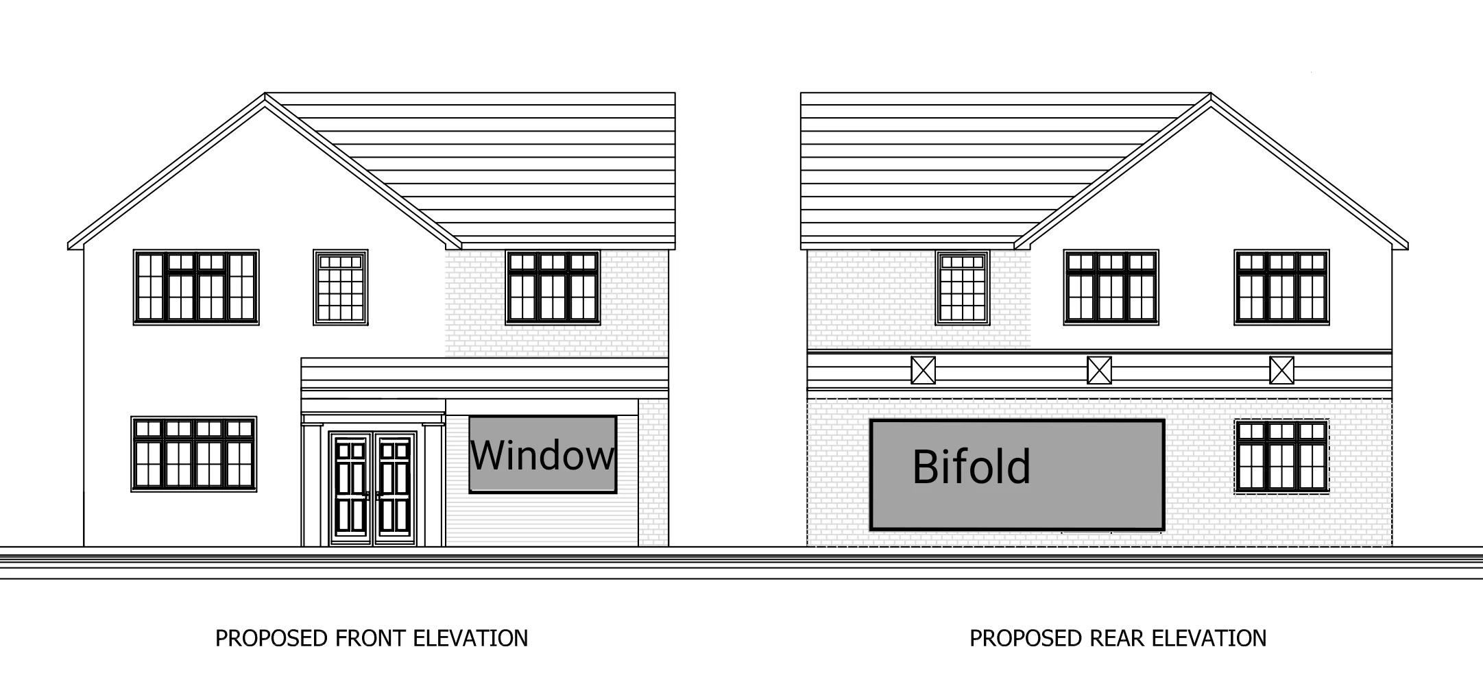

The new windows will be key locked at night and have trickle vents so no need to leave them open.
There are only 2 entrances/ exits- front door and bifold doors in kitchen (rear).
It is fully detached with passages on both sides (which are both open at the moment due to building work).
To the front of house there is-
2 ground floor windows, 3 first floor
Rear-
1 ground floor large window, 3 first floor (above extension roof.
We have a massive back garden which I'd like to be lit up at night.
I've already bought some small wall lights for new front door/ bi-folds but the rest is unlit.
