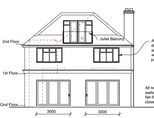

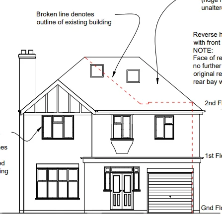

I'm going to be refurbing my entire house soon and need to get my cameras set up in place just so I know what to get where. I've already got:
  • 1 x Dahua DH-IPC-HDW3549H-AS-PV WizSense TiOC Outdoor HD PoE Turret IP Camera w/ 3.6mm Lens, 30m Full Colour, Audio & Alarm (5 MP)
  • 1 x Dahua DHI-NVR2108HS-8P-I WizSense 1-Bay NVR Network Video Recorder Enclosure (8-Channels)
The one camera I have is installed just above the garage door to the right.
Thankfully I've got some big bushes with brambles along between myself and 30 so that's fully protected, however I will need one looking down between 26 and myself.
I think one more in the front above the door to the left would be suitable to cover the whole front side
However when it comes to the rear I'm not sure what to do as I'm going to be putting a garden office at the rear of the land as well (it's not that big of a garden). Should I buy two domes cameras for each corner of the house facing the sliding doors and then a bullet camera facing the path to the garden office?
