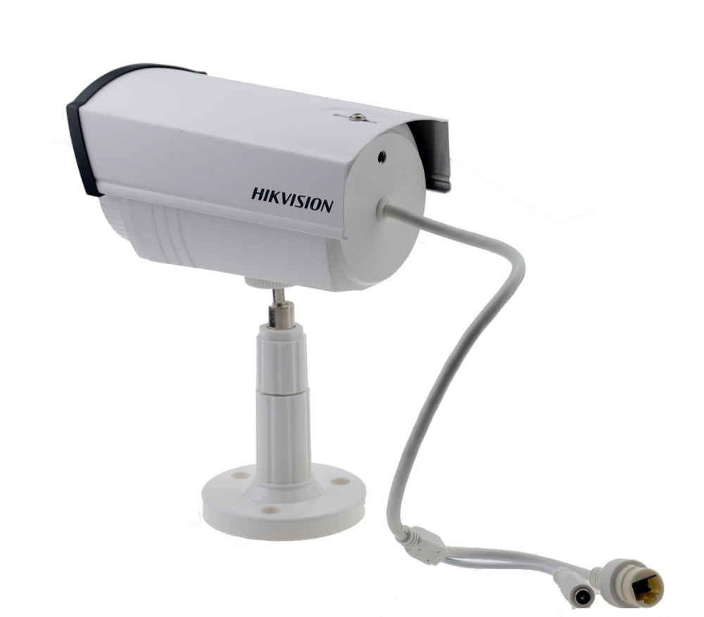

Actually another query - on the EXIR bullet cameras the cable just comes out of the back of it? The older style went through the stand from what I can see. Link to image here. Is there any issues with this other than aesthetics?

That is the same stand arrangement tha tI have on my EXIR bullet type camera. The stand isn't the best but in my case it is way out of reach. The cable is typical in how it exits the camera but I have bought 12mm diameter flexible hosing which fits the plugs and cables inside and cable and then P-clipped it to the wall and ran that to a junction box.
