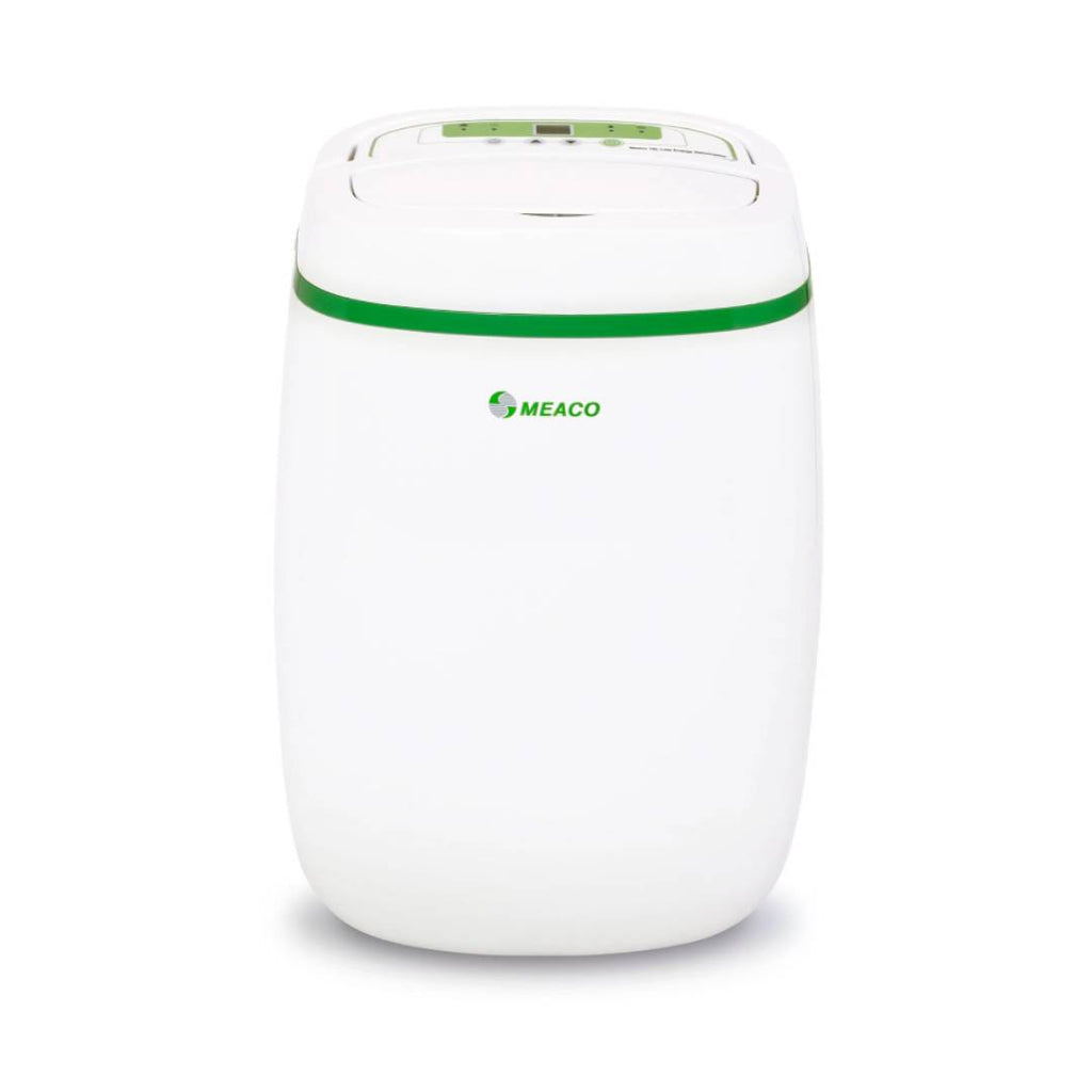

We have this one it uses half the power of desiccant one.
  • Just 165 Watts rated power consumption

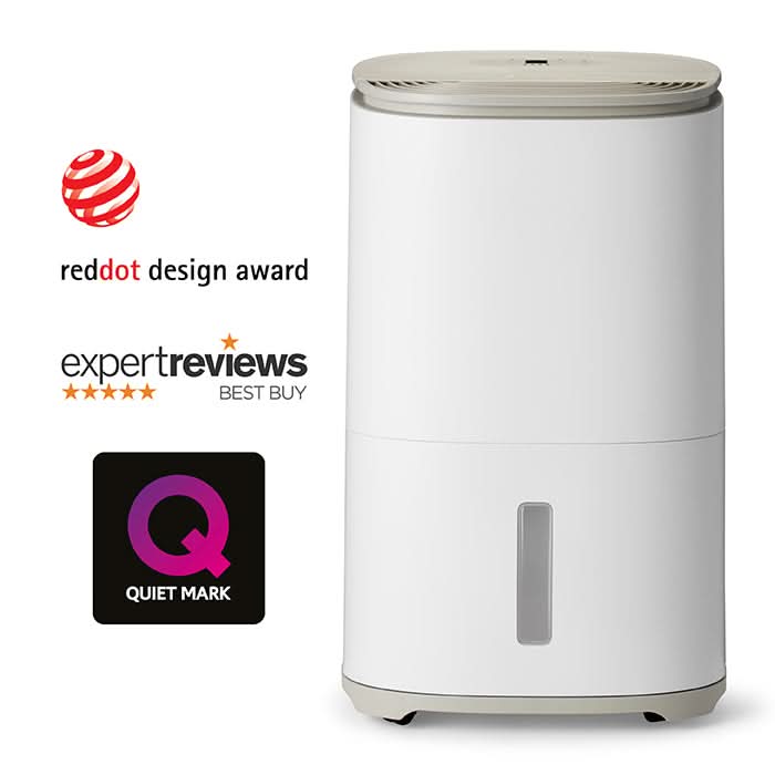

The compressor ones can be quite effective at lower temps than 20-25, i was actaully looking at that comparison recently because i bought a MeacoDry Arete® One 20L Dehumidifier for downstairs inside a coat closet (its got underground external walls and that floor is generally colder than the rest of the house (14.5c) so the RH is around 75% all the time, issues with eventual mould growth on used coats (not dirty i promise!) and stuff if they stay in there long enough)
Anyway this was comparing the data provided by Meaco for two of their models (so assuming constant test methodology, you can view the full tables in the extract rate tab on the links), both cost £259. The Arete is the compressor and the Zambezi is the desiccant.
I believe lower than 10c is where the compressor ones start to really fall off a cliff though because you can realistically only run the cooling coils so low before theres not enough differential in temps and they start to frost up. Then it spends most of its time defrosting the coils

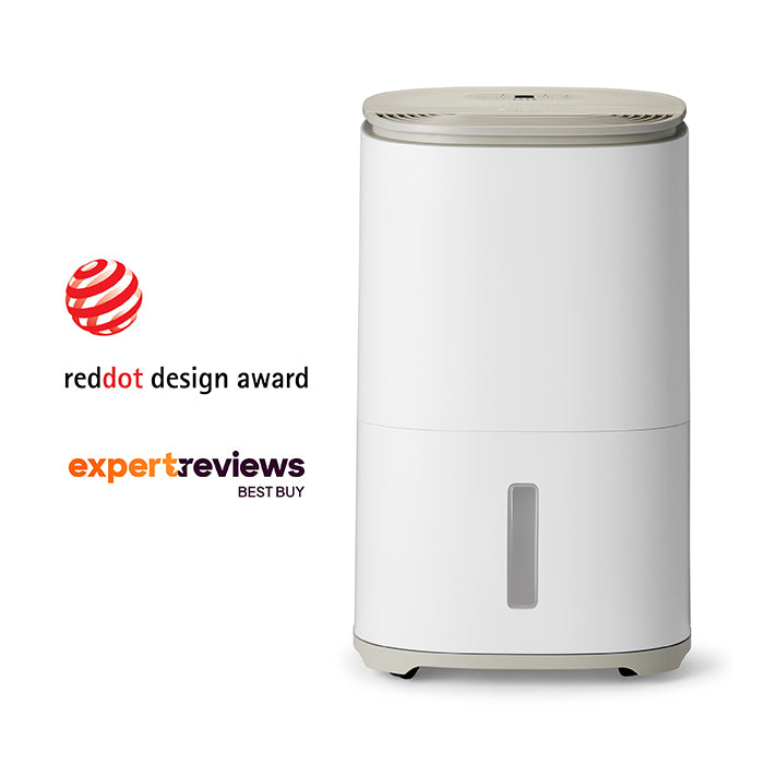

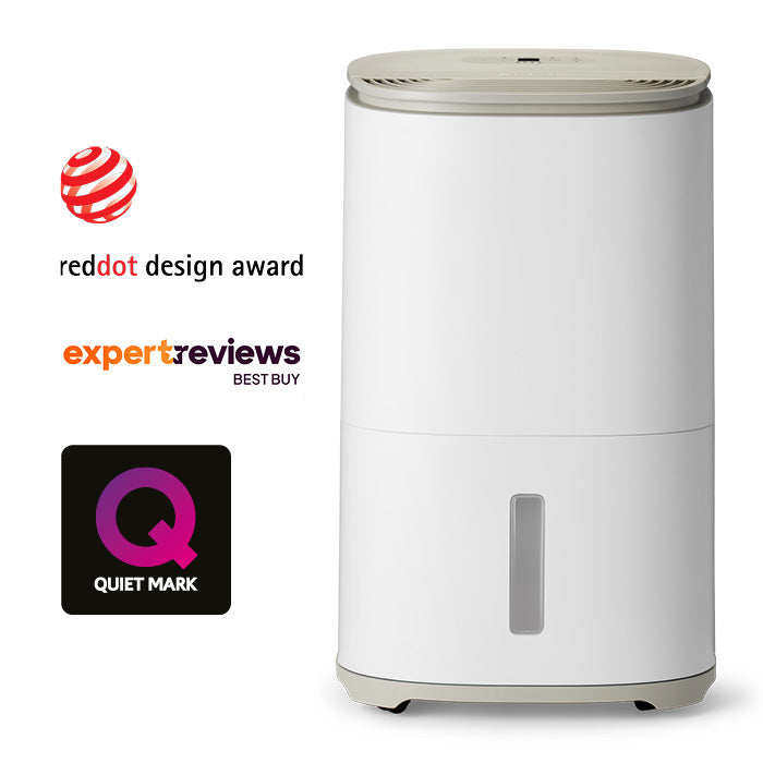

That's giving me buyers remorse! I went with the zambezi as it was beating all the other compressor models that I could find so I pretty much didn't do a great comparison of the Meaco compressor types!
At least the Zambezi ones uses more electric so it generates more heat for the house! :D
