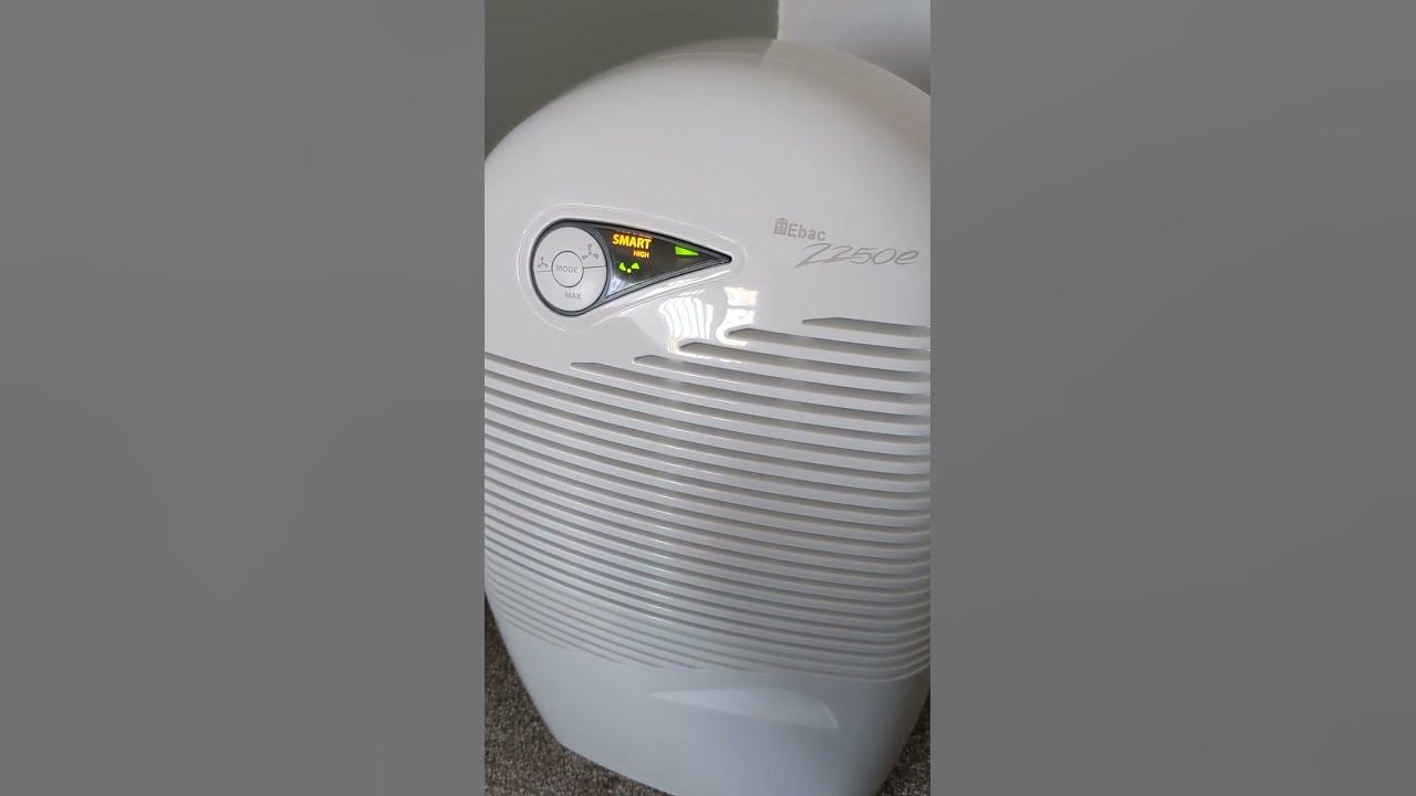

Ok so please bear in mind that the sound recorded from my phone cannot convey the actual volume in the house. Its really quite a penetrating sound when I am in the same room as the unit, but if Im in another room it can't be heard - so its not loud in terms of decibels but it is an intrusive sound.
Please listen carefully for three types of sounds here:
1. The first is a deeper sound of the fan and airflow - like a normal desk fan sort of whooshing sound. This is fine, its low pitched and not intrusive.
2. The second is a high pitched sound of the compressor. It is an intrusive fairly high pitched continuous sound.
3. The third is an overtone which sounds like a pulsing almost. Like a sine wave overtone that is on top of the compressor sound.
Like I said, its not that the sound is particularly loud in absolute terms, but its certainly intrusive because of the pitch of it and the overtone that is a continual unchanging sine wave type of noise.

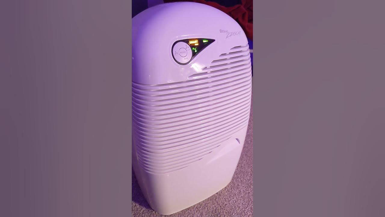

Now there is a new noise. Take a listen to this:
It is like someone tapping on metal pipes with a spanner.
That sounds like something is tapping the cooling coils - my guess would be a something on the fan.
In your previous video, I could hear the compressor and also what sounds like a dry bearing too. I'm wondering if perhaps the bearing has given way and tapping on the cooling coils?
The unit is only 5 days old. This new pinking sound started when I moved the unit upstairs yesterday. It doesn't always happen though.
Will take it back tomorrow, had enough of it. Bought Ebac because of the supposed quality and UK optimisation but clearly not the case.
Returned the Ebac 2250e.

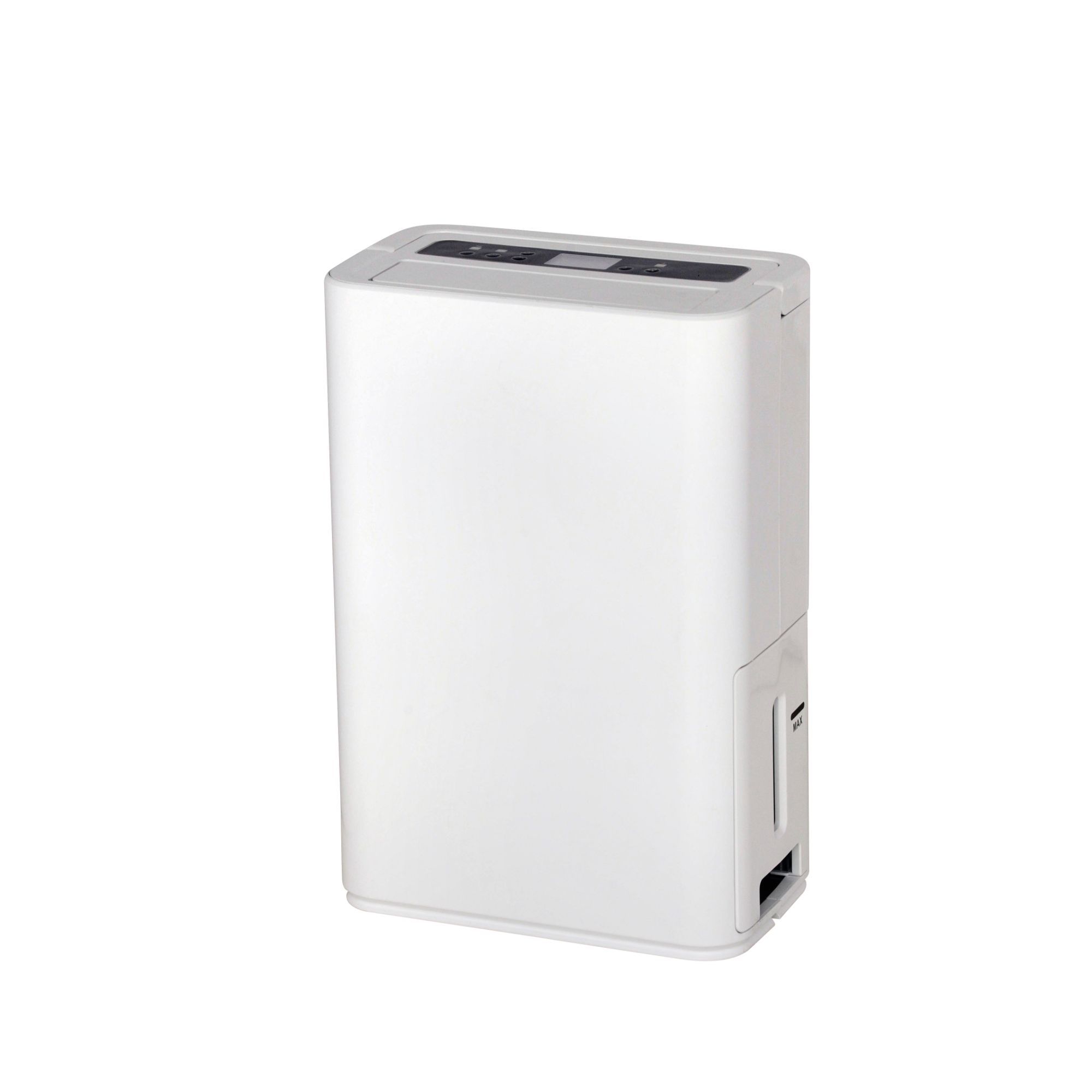

Bought a Meaco 12L, quite heavy for its size, I guess it's the compressor.
I like the target humidity setting, laundry setting too (i don't have a tumble dryer). It will be useful this winter.
(Bought one because upstairs humidity has hit 70% where i keep my guitars...and that is bad for guitars!
We have the same one, gets heavy use drying the washing, been great so far :)
