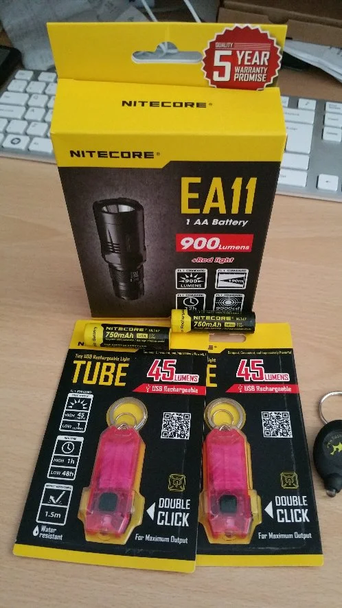

Just arrived
The EA11 is a lot brighter than my old Fenix L1T!
Don't have a light meter or anything, but figures from my Note 4 and GPS Status measured at approx. 0.5m
Tube ~ 280 LUX
L1T ~ 3700 LUX (NiMH)
EA11 ~20000 LUX (14500)
Fenix PD35 ~22000 LUX (18650)
Fenix TK22 ~ 38000 LUX (18650)

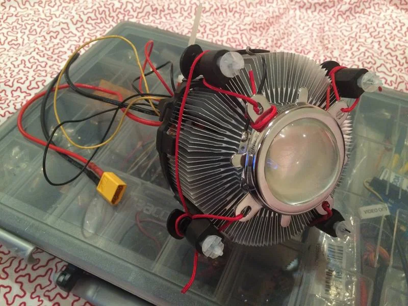

Just playing around with a 100W LED and a old Intel CPU cooler, it's ~9000 lumens :eek:
I'm going to put it in a more robust and permanent case now I've tested it :)
That is awesome. I didn't even know 100W LEDs existed!
Damn, I want to make one now :D
Lol that's ludicrous. One of those big COB LED's I guess? What are you powering it with? Making a genuine 100W into it?
To be honest, I haven't measured the current yet, but I'm certain it isn't running at maximum brightness.
It's currently being powered by a cheap ebay voltage booster like this - http://www.ebay.co.uk/itm/DC-150W-A...5V-Step-Up-Voltage-Power-Module-/391044752344 that is attached to a 3S lipo.
I'm running the LED at ~30V to keep the current down as otherwise increasing the voltage much past that will cause the current to rise massively and burn out the LED.
To remedy this and get it running at full brightness I've got an adjustable voltage and current regulator so I can run it at the full 35V and limit the current to 3A.
Like this one - http://www.ebay.co.uk/itm/100W-DC-D...767?pt=LH_DefaultDomain_3&hash=item4ae480697f
Notice the two trimmers to control current and voltage as opposed to the one voltage adjustment on the previous one.
Even though it's currently not running at full power it's incredibly bright, I caught a glimpse of it out the corner of my eye and I had a blob in my vision for 5 minutes.
The best thing I can equate it to is a camera flash gun but constant :D
Once I've got it into something more permanent and running at full power I'll take some photos and maybe a video.
It's stupidly cheap to make too, mostly from bits from ebay
LED - £3
Voltage booster with current limiter - £4.50
Lens - £2
I already had the Lipo, CPU cooler and silicone wire so it cost me about a tenner :)
