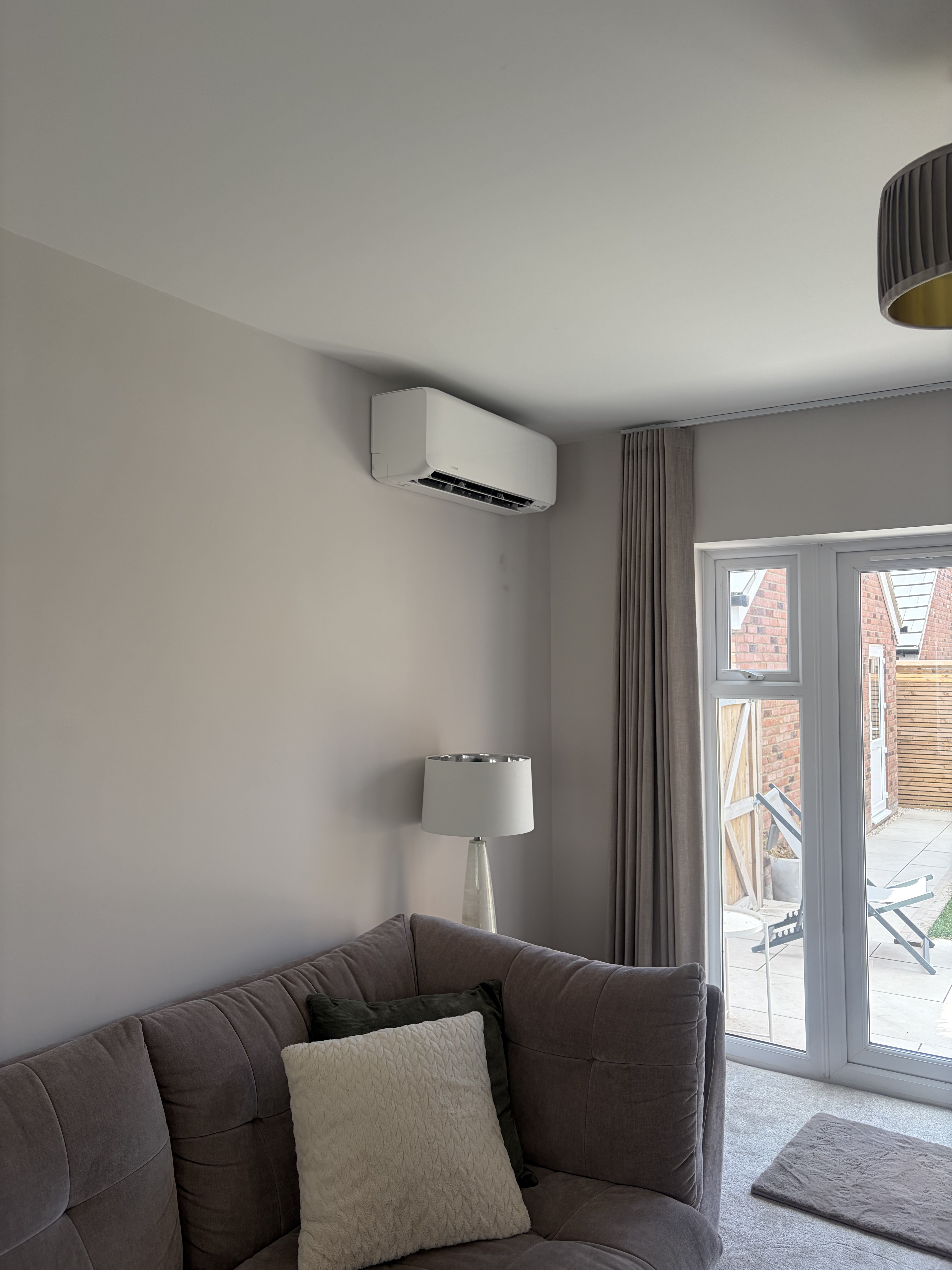

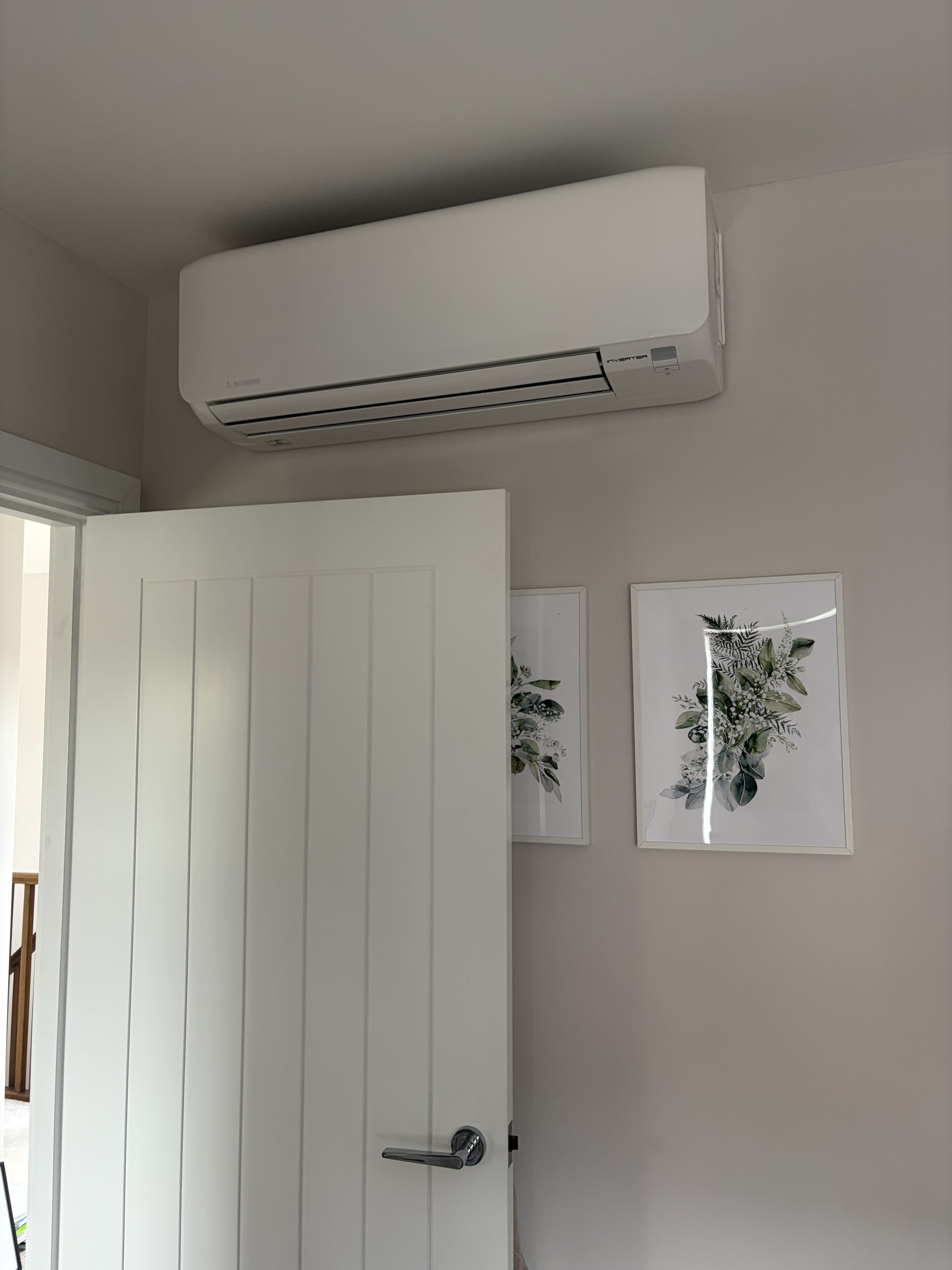

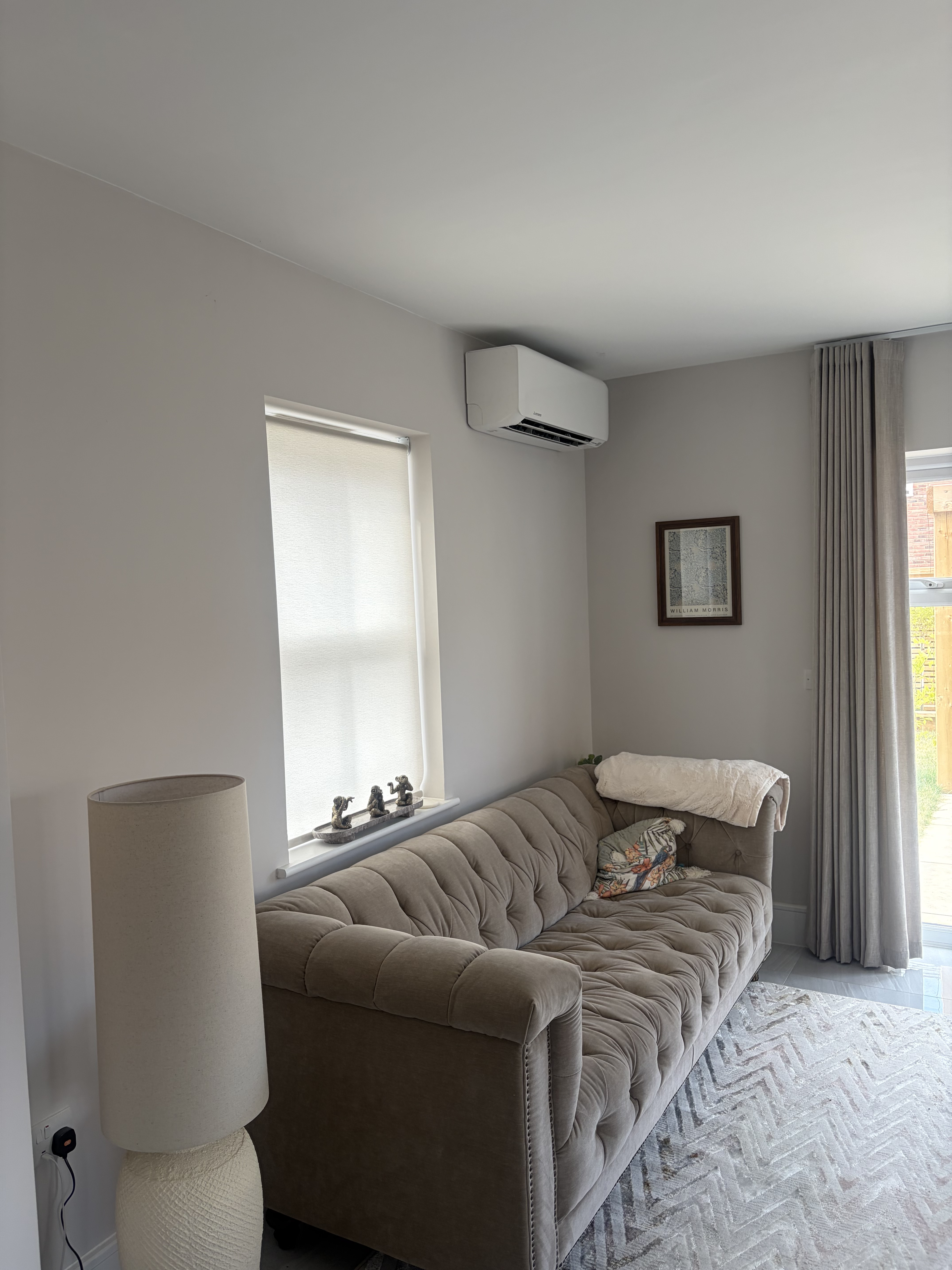

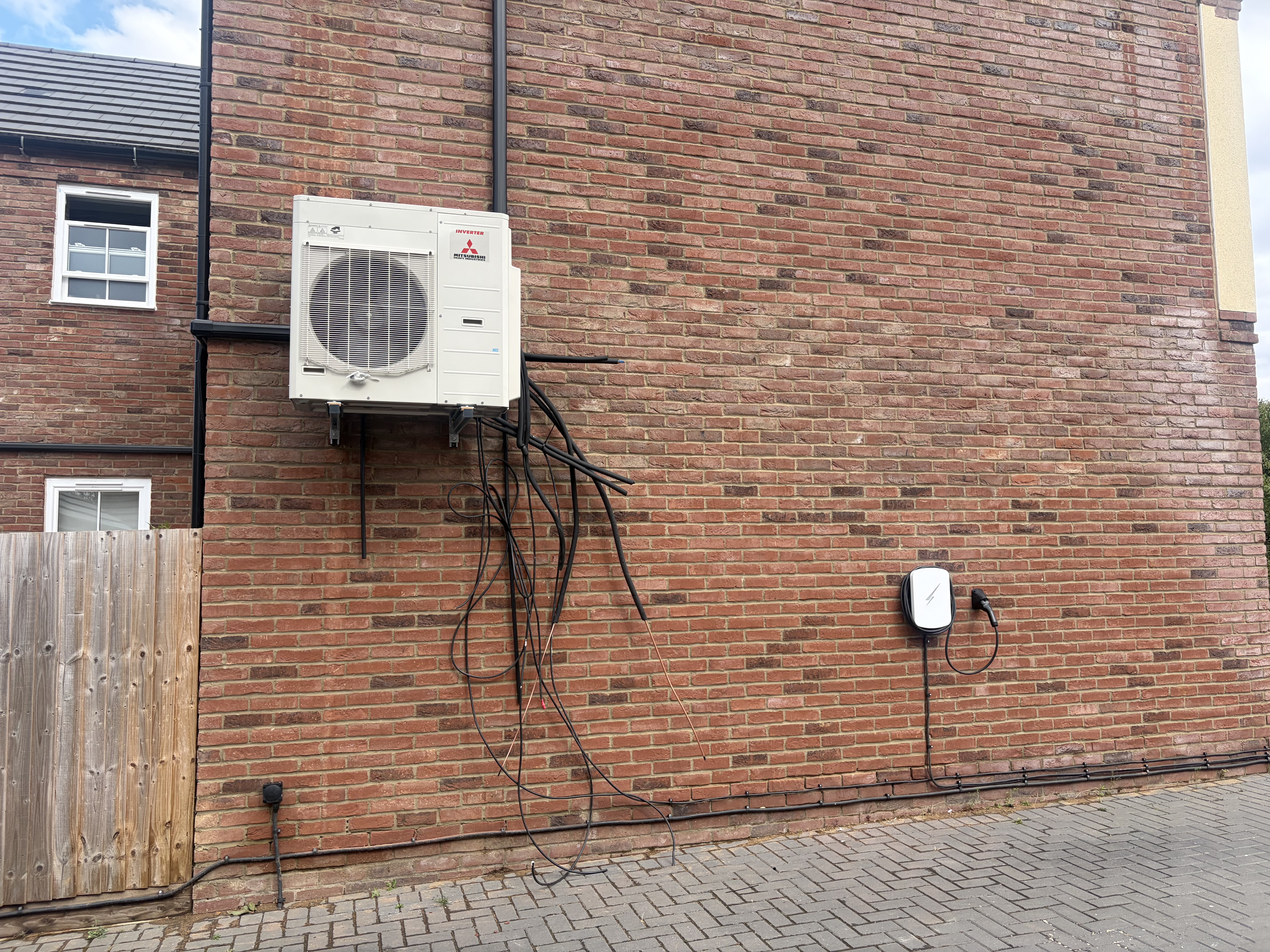

How much did you guys pay for your 4-way multi split? I'm looking at getting a system myself...
£6,500. 10kW outdoor unit. Then for indoor I have 5kW, 3.5kW, 2kW and 2kW.
Still waiting for the unit for the garage, which is another £1,300.
