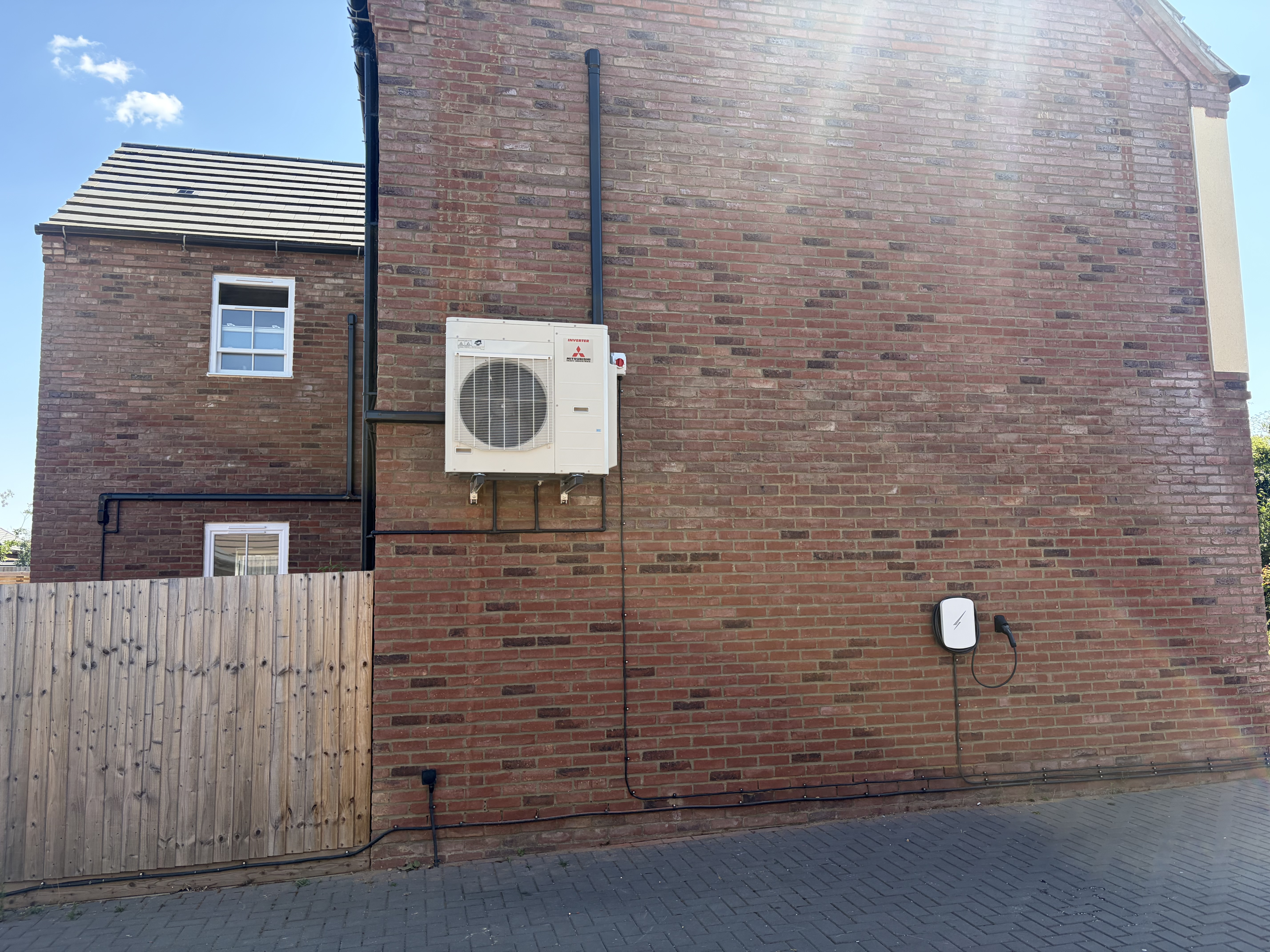

We blast ours out for the final hour or so of the EV tariff. For this reason I wouldn’t mount external units on the wall again as they are louder on heating mode in the depth of winter.

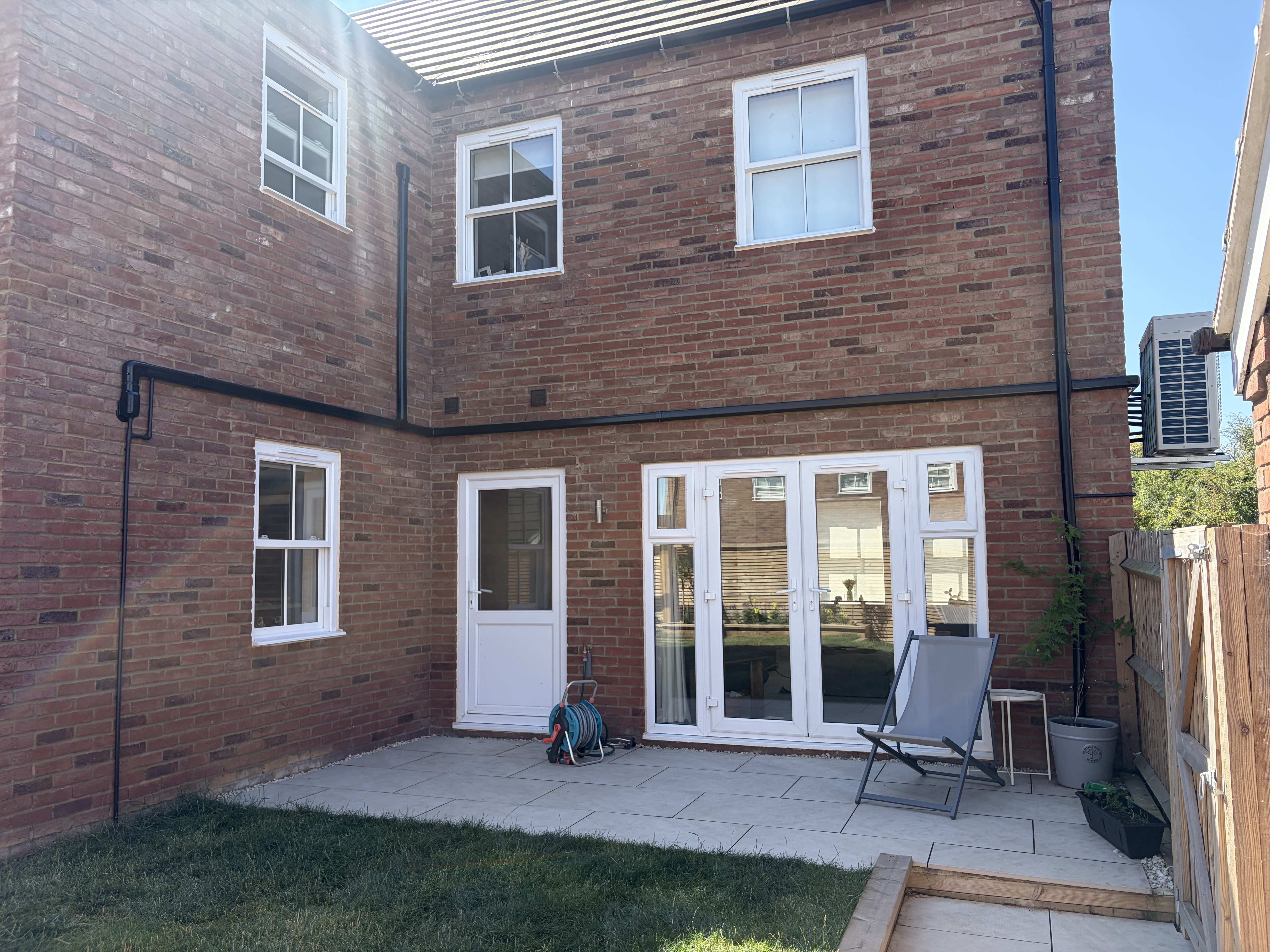

We did everything possible to avoid the loft option, luckily it was very easy to duct everything outside.
