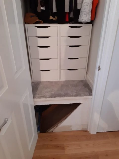

@HungryHippos That is handy your TV is right behind that wall. Yeah you could go straight through the wall there then and not need to remove skirting at all. It might be a little fiddly trying to fish the cable from the lounge side to the back wall of the cupboard though but my install was all fiddly as I was doing it on my own. If you made a back box size hole on each wall you could have someone shine a torch and maybe reach in to grab the cable rod or cable. My cable rods have a magnet you can attach to one end which is really handy with some of the other gadgets in the set.
