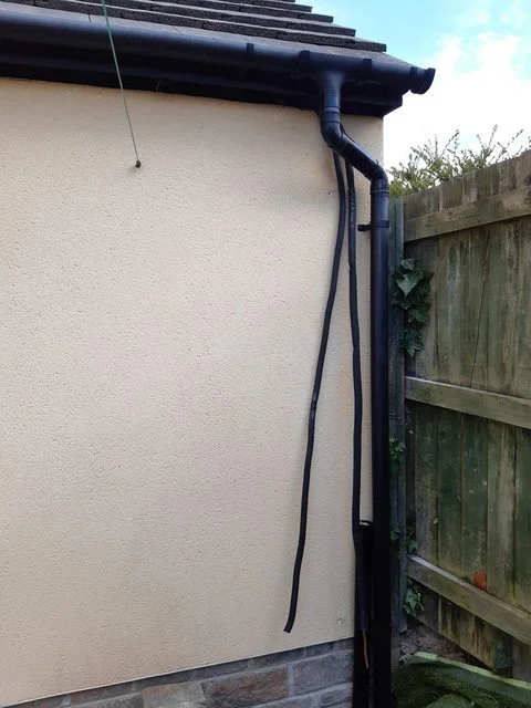

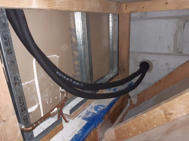

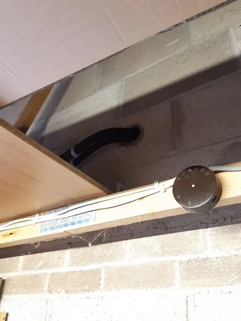

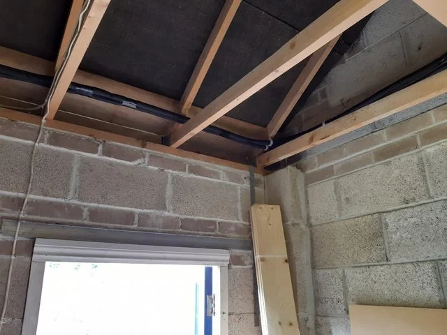

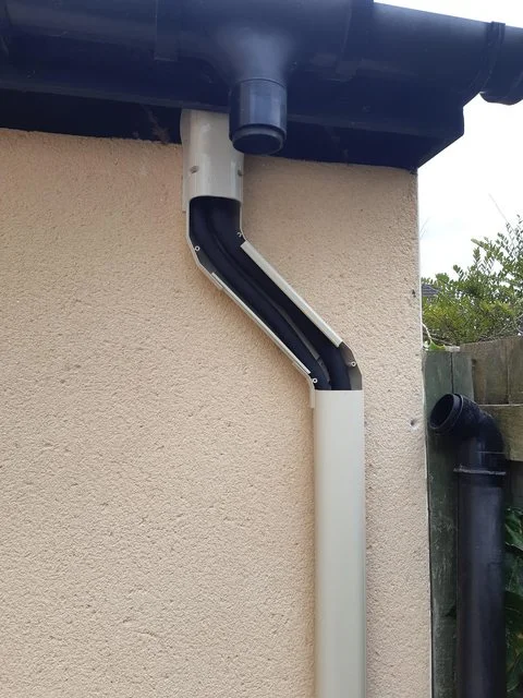

Bit more progress. Dealing with 15m copper tube coils is not the easiest thing in the world. Fortunately I had my girlfriend on hand in the loft to help guide the straightened pipe down whilst I was in the garage gently pulling.
Used a 3m length of speed fit flexi pipe 21.5mm diameter to act as a conduit for the copper as it made it's way to the exit hole into the garage which worked a treat. After it was in place the insulation went on relatively easily.
Going to put expanding foam in the hole when I have the 4 core connecting cable in place.
I had to move the guttering over to allow room for the pipes and it'll mean the compressor will be tucked further to the right which is what I want anyway. As the garage wall is north-west facing it should get a good bit of shade, maybe not so good for heating in the winter but primarily going to be used for cooling anyway. Ps ignore the fake grass in that last photo previous occupants strange choice. :p

@norm, looks great, how prone are the pipes to kinking?
Not very. The 3/8" pipe really benefits from a bending spring which sits over the pipe as you work it. I read to keep the bend radius no smaller than 70mm which is sensible really. The 1/4" pipe is easy to work with by hand, but care should be taken when uncoiling it because it could easily kink itself if it snagged on something.

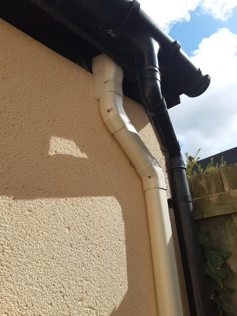

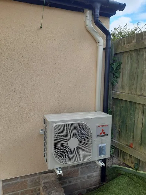

Bit of an update.
Got the trunking on and hung the compressor on the wall.
I flared the 1/4" pipe as that was the shorter of the two, so determined how low the unit could sit. The flaring went fine second time around, the first was good but I forgot the flare nut! That's after having watched several youtube videos saying not to forget it. :p
I've got the rotary isolator and 2.5mm² wiring from the garage to sort out next and then flaring the connections in the loft, then the testing can begin.
Nice! I like how you kept it in line with the downpipe, did my idea of doing that rub off on you or was it just chance?
Looks neat, but yeah what the hell on that grass!
I just wanted it over to the right as much as possible to keep it out the way, but I think the symmetry does make it look neater like you say.
Hah, the astro-turf grass is just acting as a weed suppressor for the time being. I want to dig the whole border away and replace with a retaining wall to give a storage area. Annoyingly when the property was built the builders piled soil against the garage wall on the right side far above the DPC so it's causing damp inside during wet weather, hence it's all going to have be dug back.
That's shoddy builders for you to be honest! That + throwing as much rubble into your garden as possible.
