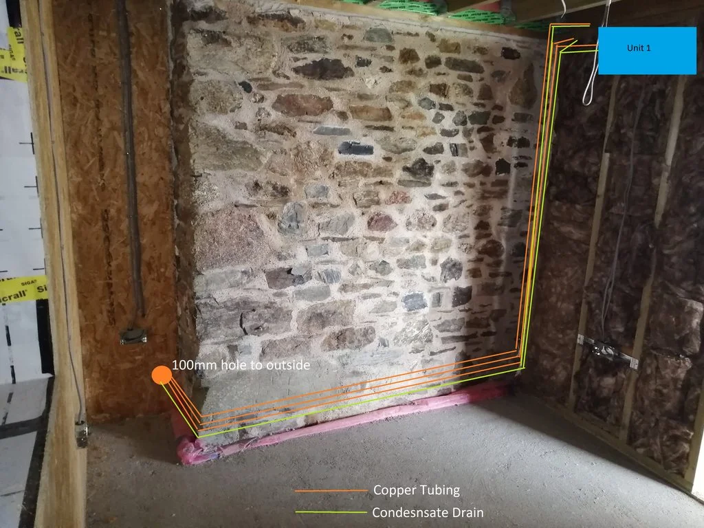

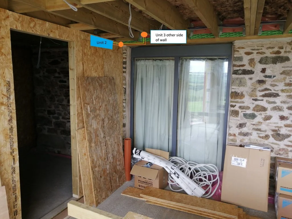

Here's a couple of pics showing where it is to be installed and planned pipe runs:-
So, from the first pic bottom right, other side of the 100mm hole in the wall will be the outside wall mounted unit. I'll be making a boxed section on the ground there to cover the floor/wall edge and the red plastic DPM, so will be running pipes in there to cover it all. Another boxing section then vertically up the corner of the wall to cover all of the pipes here. Then there is Unit 1 in this room, and the pipes will come out of the LHS and be surface mounted in conduit to the boxing. Next pic, shows Unit 2, and the plan here is to have the pipes coming out of the back of this unit, straight through a hole in the stud wall and into either the conduit or straight into the vertical corner boxing. Last Unit 3, is other side of that wall, and again will be taking the pipes out of the back of Unit 3, and there will be more boxing built which covers the top 10mm of stonework which can also cover the pipes here. So quite a few 90deg turns in not much space.

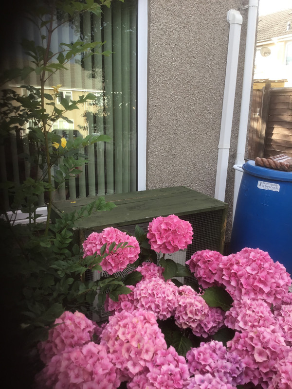

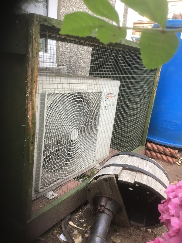

I installed mine last year and it’s been an absolute god send although we’ve rarely used it for cooling but more for heating during winter. Wouldn’t be with out it and I still plan to fit one in our bedroom at some point.
Not quite as tidy as some of the others on this thread but for £500 all in I’m well happy. Had no issues what so ever neither have the company I work for who have 2 units that have been running trouble free for 2-3 years now.
