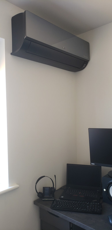

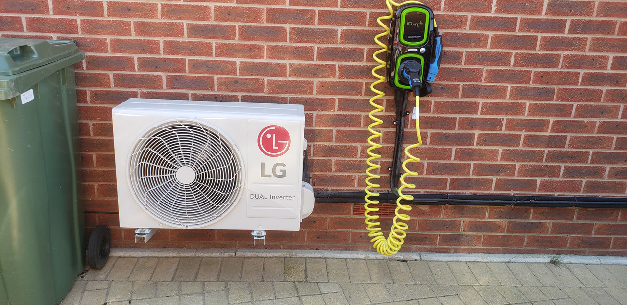

Just had the one unit on in the lounge as I've been downstairs most of today, as outdoor temps aren't insane (although bit warmer today granted) I've mainly been using the unit where I am as opposed to switching them all on.
The single 2.5kw unit was turned on at speed 3/5 on cooling mode, is using one unit of the 3 on it's own an issue? Not something the installers mentioned.
