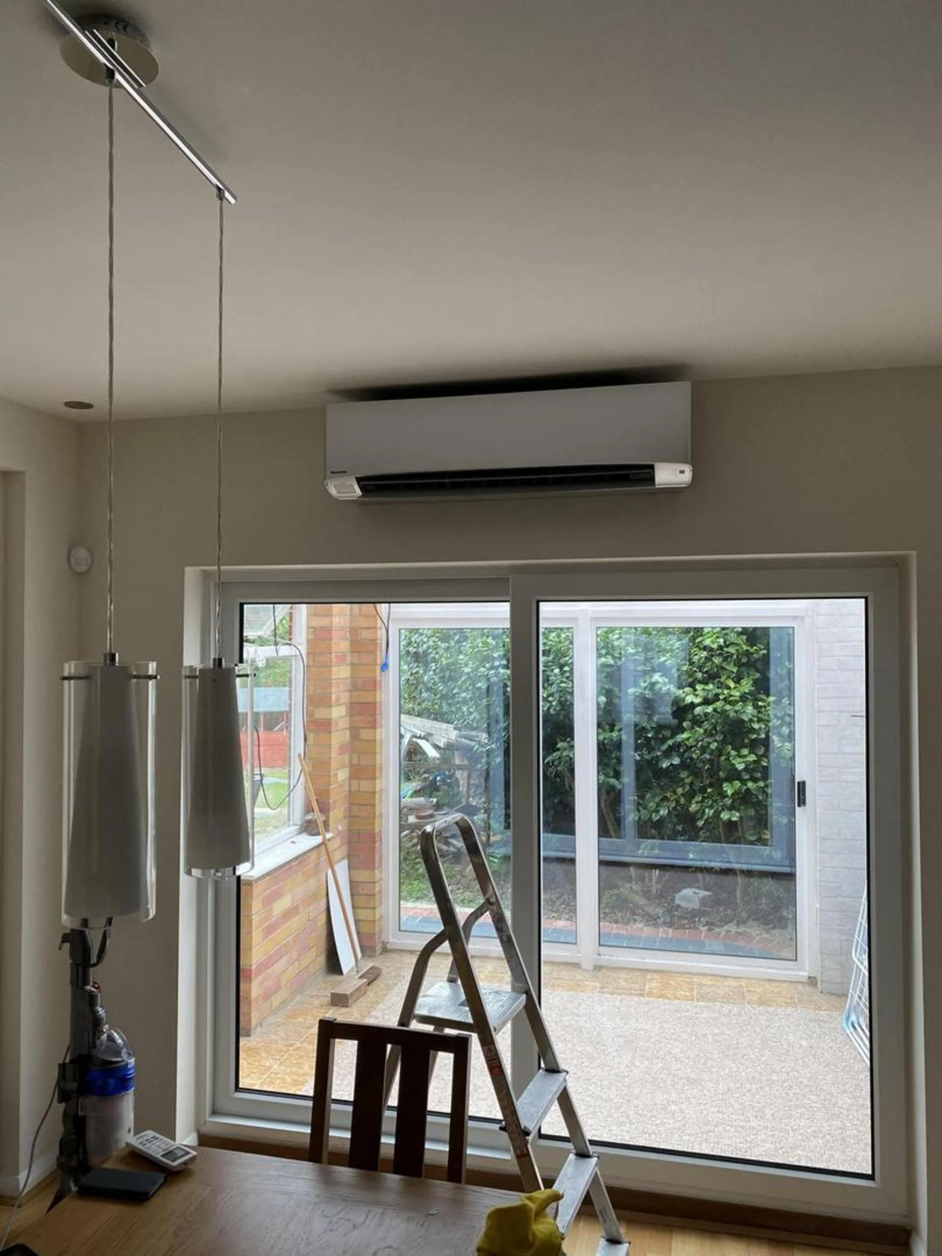

If this is the show us your AC thread, then here is mine.. note the cunning use of a fake drainpipe for cable routing which matches the other side of the house. Really pleased with the LG indoor unit and the outdoor one is nice and quite, not that it would bother anyone.
Nice and neat install!
The bigger the outdoor unit the louder it can get I guess, with mine being 3 indoor ones to one outdoor one it's more of a consideration to make. Running 1 unit it's pretty quiet though for sure. All 3 on max it can go reasonably loud.
Very nice :D

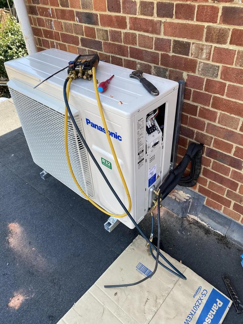

Evening All,
The install went well and everything is up & running, managed to get the WiFi adapter working with the Pansnsonic cloud software.
I gave them a hand getting the unit on the roof.
Next jobs are soffits and sort out the Sun lounge, sorry sauna!
Some images below:

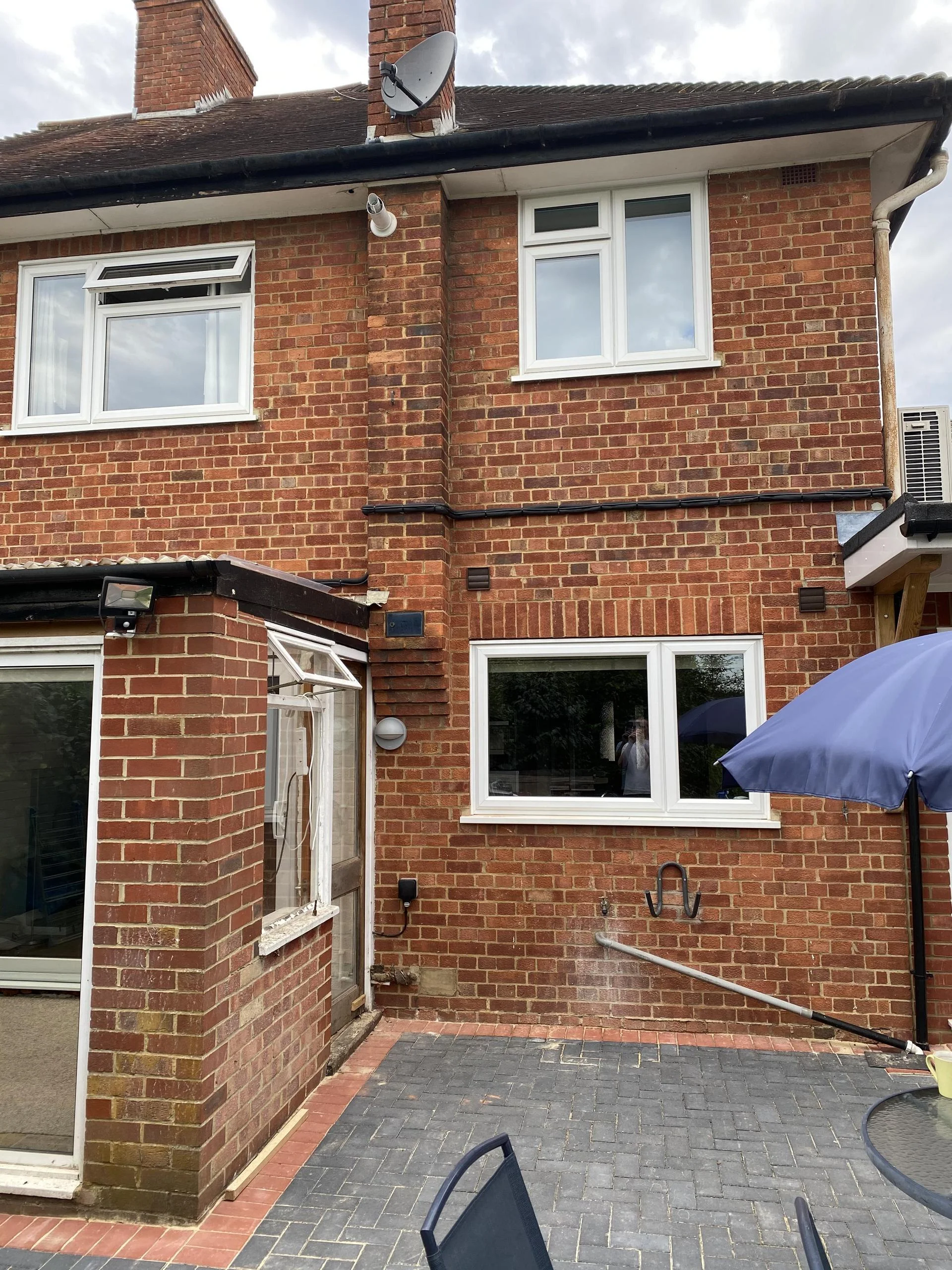

That's a convenient out of the way location for the compressor there @RJC, when you see some mounted halfway up a wall you wonder how they got it up there without scaffolding even two people lifting it with two ladders would still be a bit dodgy given the weight. Did you have similar issues getting to the flat roof bit?
I thought you had AC already, is this replacing the other unit, or in addition to it if so where have you got the other one sited out of interest?
Does the drain from the evaporator track behind on the wall in your conservatory?

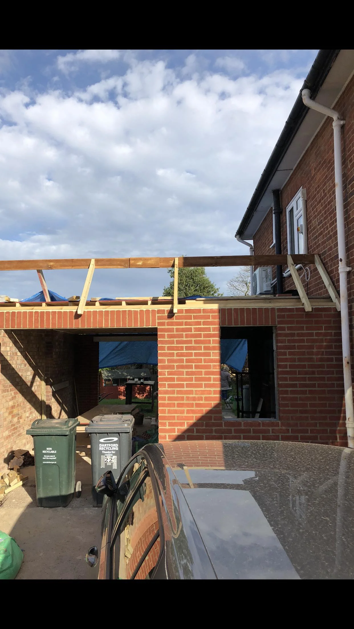

@norm the other unit sits beside this one which myself and my Dad installed a couple of years ago with the use of a scaffold tower which was fun - this
one cools the hallway (helps heating in the winter as I have no cavity) and I use a fan to assist cool my bedroom down.
This one is 5kw and cools my dinning / living room down.
The drain for the new one as you mention goes into the conservatory, beside the door, I think you can just see a white line 2 bricks up from the ground where it exits and also the isolator switch is there as well.
Edit:
Pic of original one, whilst my extension was being built;

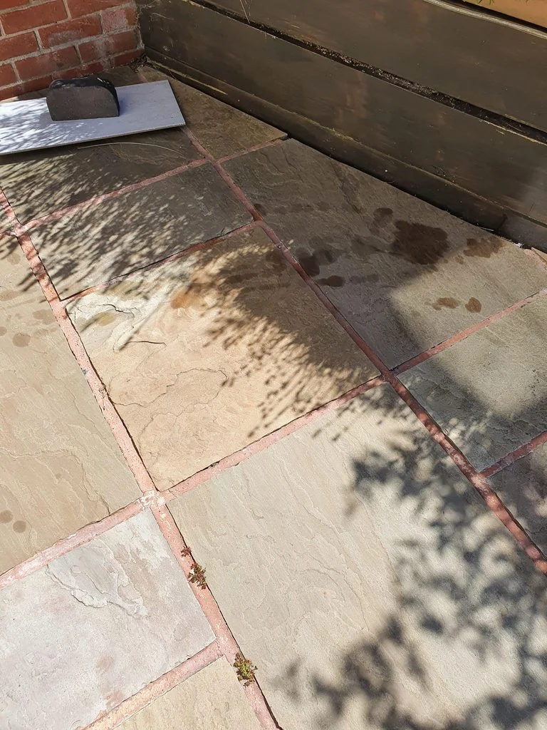

Remaining slight annoyance is they have spilt something on my patio when they were here the other day, don't know if it's refrigerant or something else, but seems to have stained the flag stones.
Despite the recent rain and trying to hose it down, it isn't budging. It looks like it's got water permanently spilt on it even when dry. I was eventually going to look at changing the patio, but that was a down the line job, and may have just involved relaying the existing flagstones properly.
