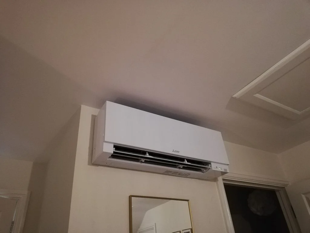

Have you got decent images of your units? Be nice to see outside the marketing material

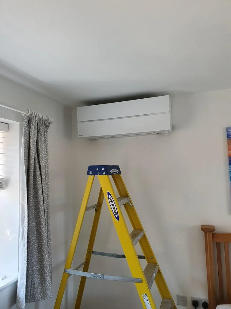

Actually all my previous pics look a bit blurry and you can't really see it that clearly. I have taken this tonight so not the best lighting but clearer than the rest. My friend has a black version of the same unit and it really stands out on his wall which make it more of a feature. The white ones definitely blend in a little more to my color of walls anyway.
@ShivP I have the MSZ-LN in the plain white. Both the Zens that @fobose posted and my ones are the more premium models they do.
They do a fancy black version of it though that could look good in your case.
Nice - they both look good. I think may as well go for the MSZ-LN for the minimal cost increase.
