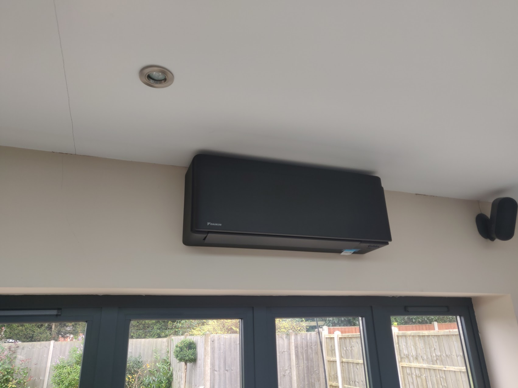

Had 2x Daikin 5kW Stylish units installed at long last....look good
One issue I am having... on heating mode, the units never seem to stop heating. I have set to 21.5c at the moment, and they shoot above 23c before the fan even slows down on auto mode
What is strange is on the app the units even know that the room is at 24c but they keep kicking heat out
Is there any calibration or something I need to do?

Looks nice with colour being similar to the door frames :)
Mine seem to take a while to kick into heating mode, maybe 5-10 mins before it bothers to kick some heat out, works fine after that though. Mine also stop heating after a bit so that bit works at least.

OK... tis a little frustrating at the moment to be honest but only had them for one day so I am sure I'll work it out! They are both currently set to 21.5c and the room is at 24c according to the units and 23.8 according to the hive thermostat (for underfloor heating)
Can't understand what I'm doing wrong to be honest
Got lucky with the colour, the other option was black "wood" which wouldn't have fit as well with the speakers mounted on the wall etc... however Daikin released these relatively recently so worked out well
Yeah remember they are monitoring the temp on their intake - and being at the top of the room where heat rises means they will often read higher than the room really "feels" and hence the large differential before they stop heating. The opposite is true for the cooling - they often seem to cut a bit conservatively but that's just because the temp at the sensor will be a bit cooler than the room "feels"

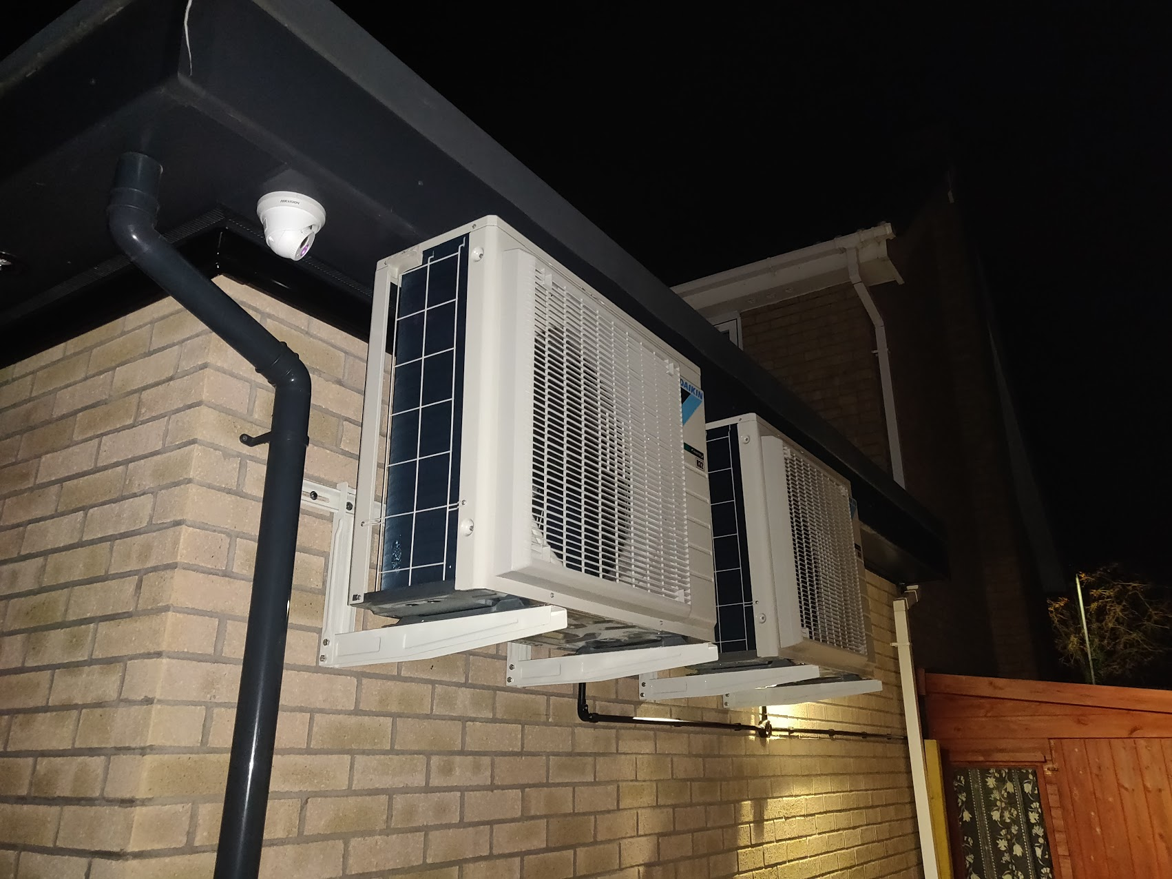

Looks good @ShivP! Those are some beasty looking external units :D
What does the condense pipework look like on the wall the internal units are on?
I'll send some photos when it stops ******* it down. The condense pipes haven't been done yet, they are coming another day to finish it. Unfortunately I think they are going to look ****, which is a shame as the copper and power looks quite neat and is up against the fascia

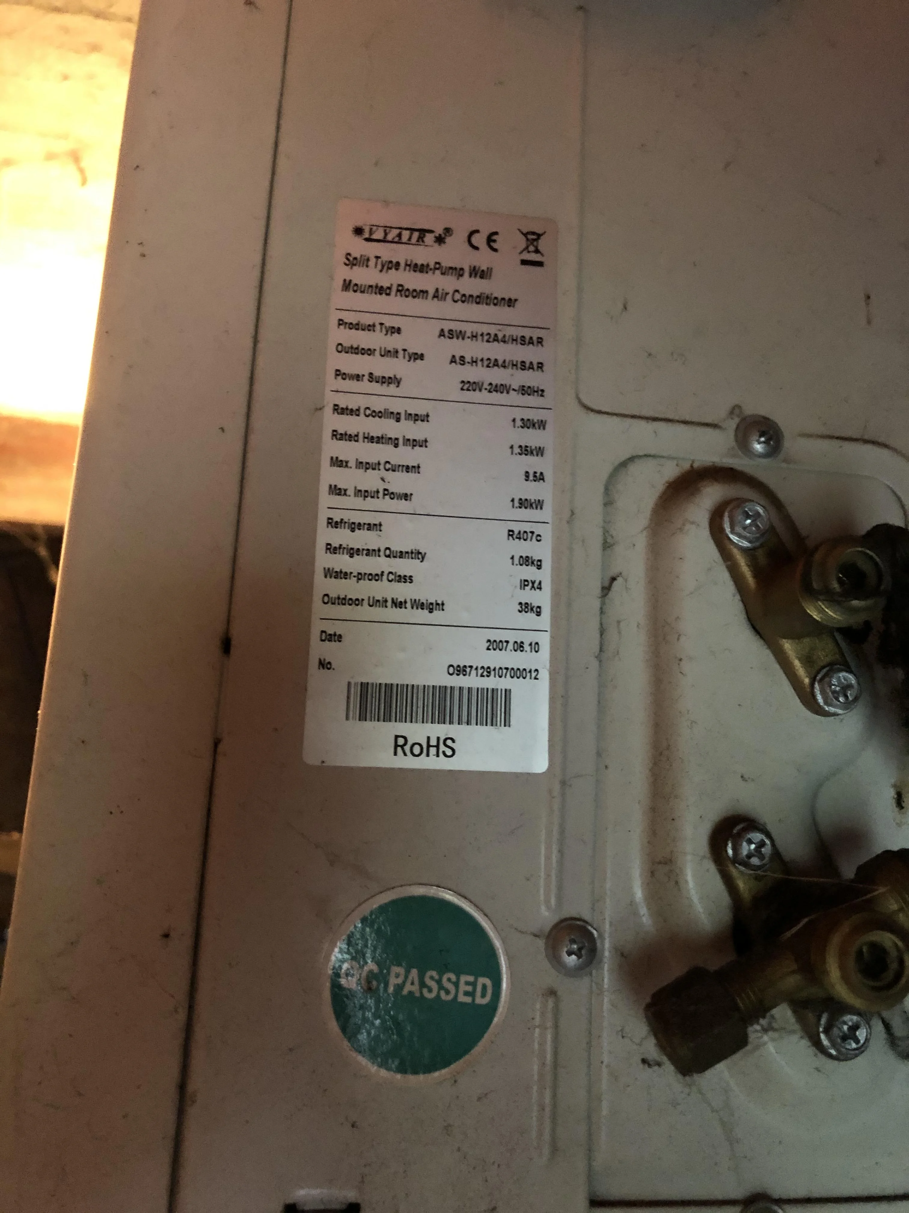

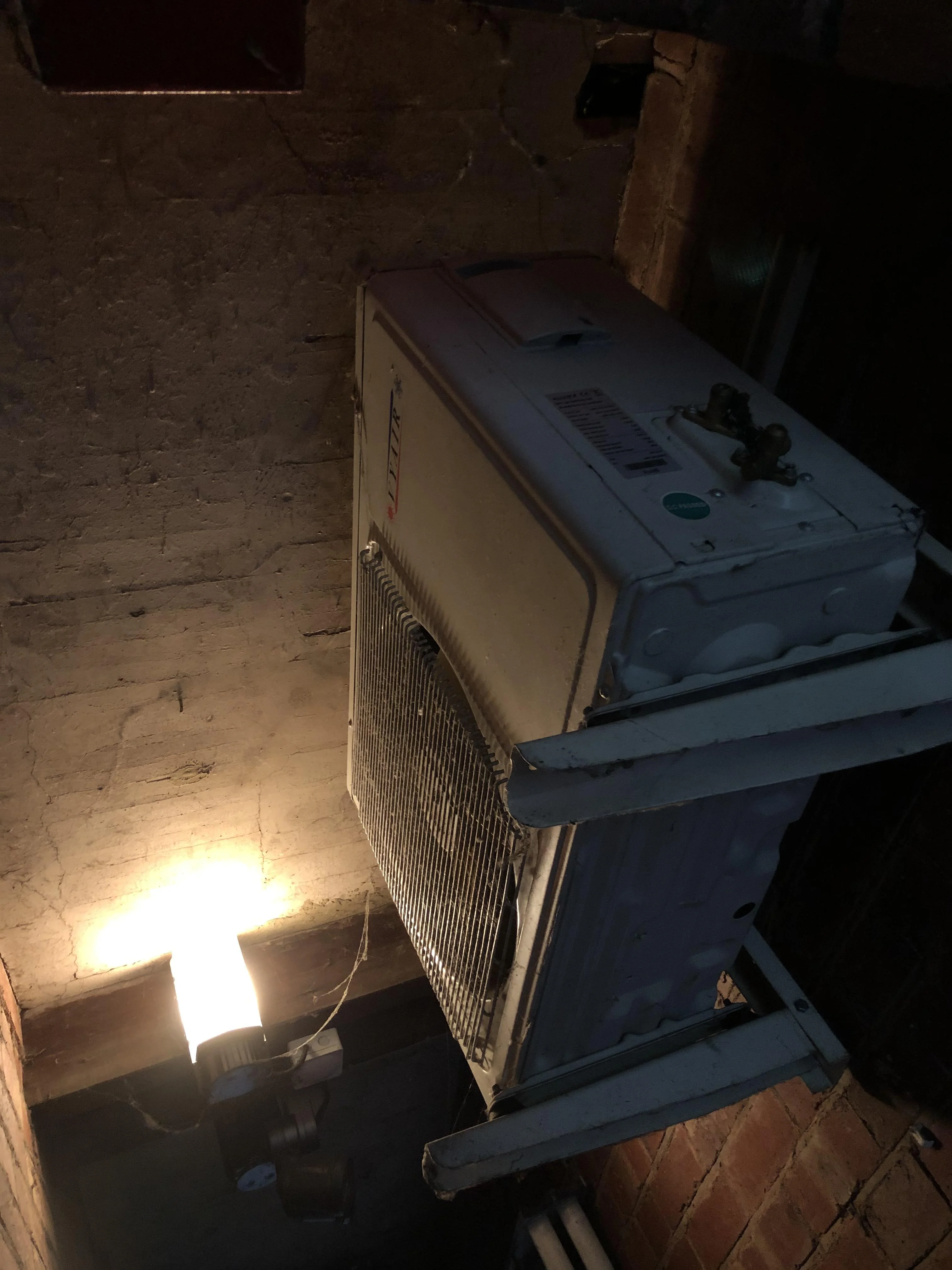

I was viewing a house earlier today and I noticed what looks like part of split unit mounted outside. I don't think its connected to anything as as I couldn't see any pipes going to or from it and there were no vents inside the house. It looks like it has been there for a while and needs a good clean. The current homeowner didn't know much about it and seemed to have forgotten that it was there until I asked about it, according to them it was there when they bought the house.
A quick google doesn't show much information, is it something that is worth keeping and trying to get working? i don't know if it works. if it is junk is it something that will be expensive to dispose of?
Looks like its decommissioned, no power or pipe work.
Whether they blew the gas off or pumped it down is the question.
If devoid of refrigerant you could take it apart and use the copper for scrap and recycle the metal work.
Thanks,
Is there an easy way of telling?
The easy way is to check the valve, if the screw is all the way in on both then they could have pumped it down, if they are then you can crack the the valve for a split second - I would do this on the larger valve and see what comes out (The correct route is to put a set of gauges on and check the standing pressure).
