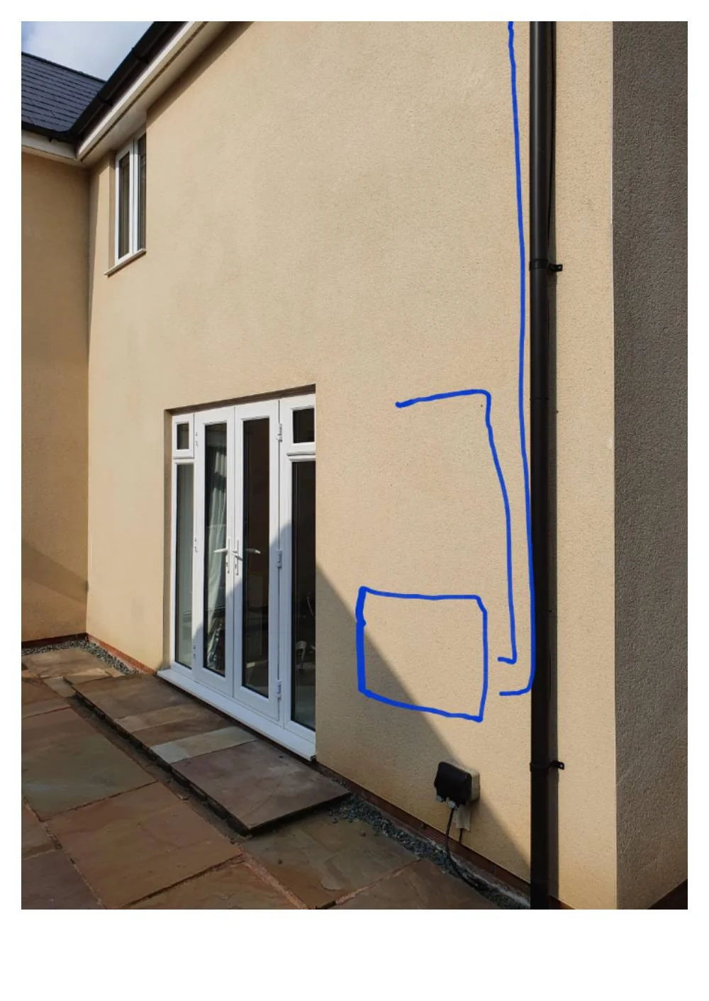

Having looked at your updated photo that wall has more room at the bottom than first appeared.
Siting it there with black trunking to match the down pipe would look quite neat and being ground level easier to service.
I think if I was only going for the two rooms without potentially adding your master bedroom, I would look at norm's second suggestion. You would only need one vertical drop for trunking, the living room's trunking could T in to the bedrooms (I've got two rooms pipe work in quite a bit of the 70mm trunking so it's deffo doable).
If you were swayed to get your master bedroom done too, I might opt to have it in the corner as I suggested but only if you could mount the lounge internal unit close to the external unit (i.e you would need to hang your door the other way so it opened on the other wall in to your lounge - depends how your living room in set up). If you go above your patio door you would need to have a pipe dropping straight down any way for the condense so it would add more pipe work / trunking.
*edit*
something like this. Note, the red circle could be where the lounge pipes join on to the bedroom/office trunking.
P.S I have seen white trunking too, that might make it less obtrusive!
The alternative is you get a tri head compressor like fobose has, site it in the same place to the right of the patio door, but in the case of the master bedroom you take the lines all the way to the top through the underside of the fascia soffit and route through the loft.
Ultimately I think that will give you the neatest solution all round with minimal trunking on show.

Siting it in the corner does mean quite a long trunking length to get to where it needs to go, although I could probably follow under the render around and then up where required.

This does mean I may go ahead with the side wall option as per one of my earlier images. 2nd company have also said it can just be mounted on the floor on anti-vibration legs as well. The cabling should run reasonably neatly along the underside of the render, and then I can use the guttering to mask most of the ascent, even if the trunking just runs up parallel with the guttering.
If I wanted to add the master bedroom on then the outdoor unit would need to be one that can serve 3 indoor units, and it is of course quite far away from the master bedroom, which is a challenge. Although one thing I could do would be to have that running under the patio, which I will be looking to change at some point, so could get a new patio in the future, and ask them to run some plastic pipes under it so I can channel the cabling under it, that would be nice and neat, but would certainly be a job for the future.

I originally was having mine on rubber mounted feet on the floor but I changed to wall mount as I was thinking of changing the patio in future, only reason I changed. What rating are your downstairs sockets out of interest? Should tell you on the MCB in the consumer unit (Mine have 32A on the text).
