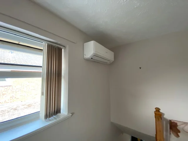

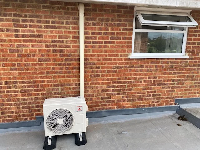

So my first one is in, no issues. It only took them a couple of hours. The inverter is on foam feet on the garage roof and the pipe run is super short to the wall unit, through a 70mm hole. It's at the top of the stairs pointing into the master bedroom.
It's a Mitsubishi Heavy Industries 3.5kw cooling / 4kw heat unit.
Very impressed by how quiet it is. Completely astounded by how much heat it kicks out in heating mode, unbelievable.

A very simple and neat install! I am not a fan of the style of the internal unit, but it is in your hall way in a location that you won't be looking at very often so a complete none issue. I will be keen to know how it does keeping the bedrooms cool in the summer, hopefully you master bedroom stays cool at least if it is blowing in to it.

Mine is in the same location - works a treat. But! your landing will reach the set temp in minutes and throttle the unit down, leaving your master room too warm or too hot as it will take the temperature from where the indoor unit is located.
So make sure you use the "follow me" function on the remote and place it in the master bedroom pointing towards the unit.
I'm sure you knew this but just in case :) it will then use the temperature of where the remote is rather than he temperature of the landing.
How is the outdoor unit fixed to the roof? is it simply resting, or did they bolt it into the roof?
Only day 1, but we don’t notice it. Agreed we wouldn’t want this in a bedroom or living area but it’s at the back of the stairs so you only see if you look up. It was also very cheap. The fitter said it was the simplest possible install as we had power, didn’t need a condensate pump, and we’ve gone for a more basic unit. Installed, the bill was 3 figures so a lot cheaper than some of the systems quoted here.
It’s resting as far as I know. The feet feel like the material you find on the ground in children's play areas. The unit weighs 30kg+ so I don’t imagine it’s going to move anywhere in a hurry!

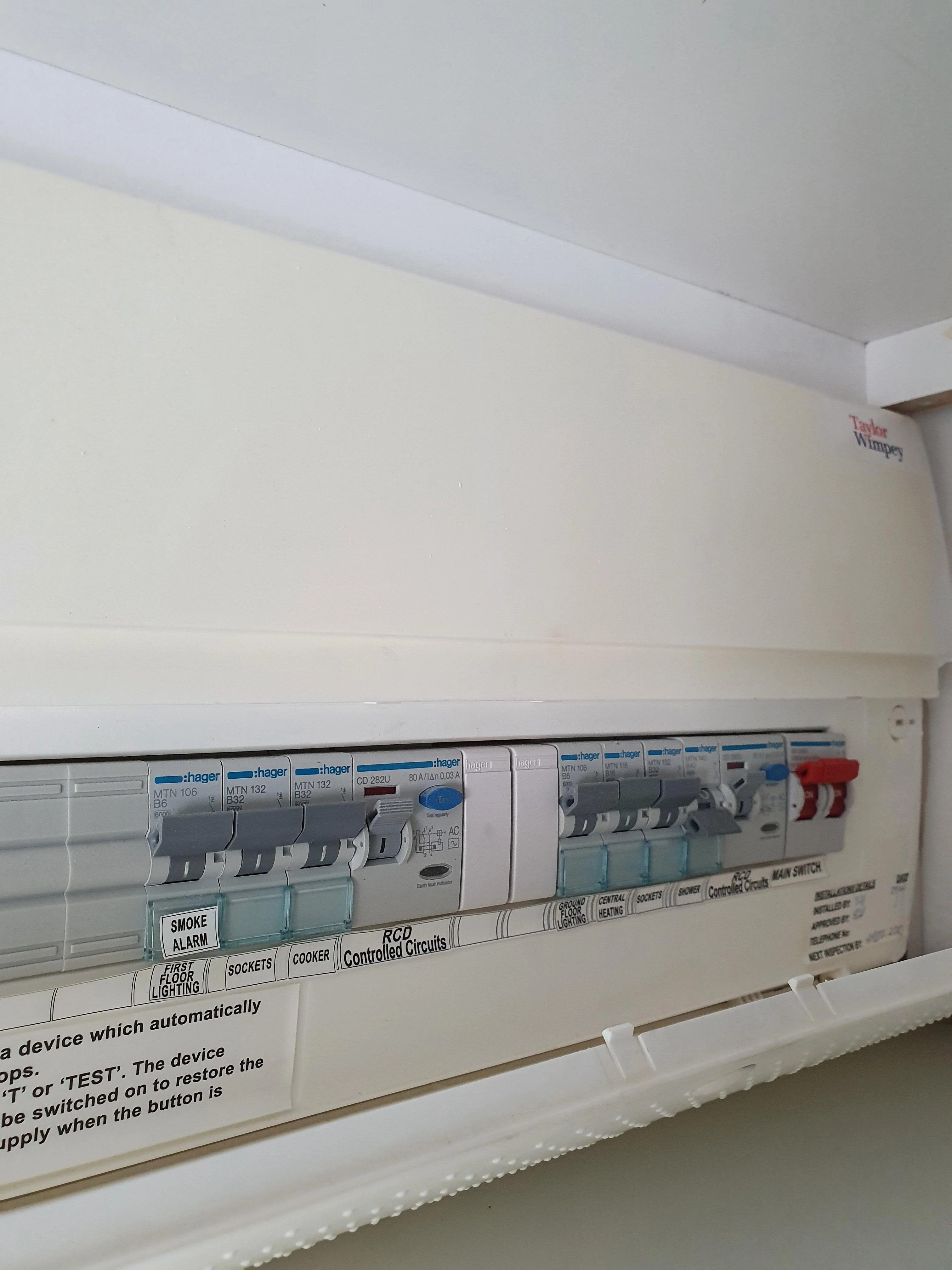

What are your sockets rated at on your fuse box? All of mine are on 32A MCB's. 7500W / 240V = 31.25A so maybe I would not have been able to go up to the next size unit (7.5kw) after all. Would not leave much room to use anything else in the house.
The AC guy did ask me what other equipment I ran off my sockets during the quote stage. I mentioned the usual; kettle, iron, coffee machine, kitchen aid etc etc.

Not sure, does this help?
Same as mine (B32 = 32A) on both your upstairs and downstairs socket. I think with your 3 rooms from your first Mitsu quote (3500w, 2500w, 1800w / 240v = 32.5A) you have too much draw which is why he probably suggested to put in its own run. Both the smaller units (2500w +1800w / 240v = 17.91A) should have been fine though I would have thought but maybe he got to see what else you have plugged in to your sockets etc.
Ah think I got it, so I could realistically have 3 x 2kwh units inside, with an outdoor unit at say 5 or 6kwh (20.8A or 25A respectively) instead, which would give a bit of leeway for other devices running off the sockets to operate without exceeding the 32A limit?
Wouldn't give much headroom at 6kwh but that would only be used if all 3 internal units were running flat out at the same time.
