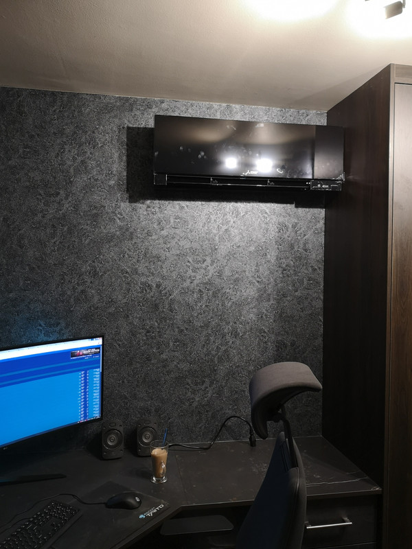

Nice! Mitsubishi Electric? Mine are the LN25 range which really look great.

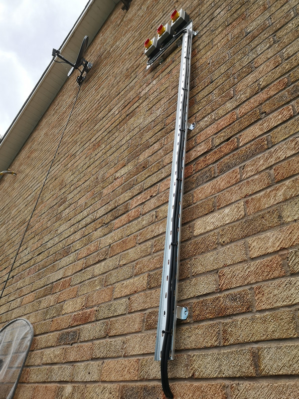

Happy to be schooled but it just makes no sense to me to install the isolators in a place which makes them completely inaccessible. Apart from not understanding the logic behind it, I’d have thought that there are regs against that as well.
I'd agree with that tbh, wonder why they didn't set them lower down.

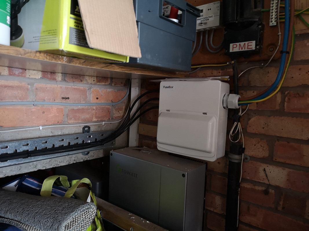

It was my request actually, just wanted them out the way as we have ladders and other bits we hang on this wall, but I can turn them off at the fusebox in the garage. Pretty sure the isolaters are just for them to flip off when they do the service/maintenance.

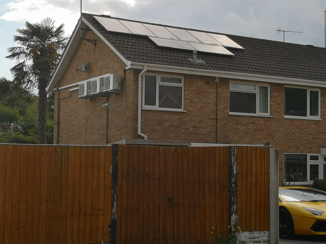

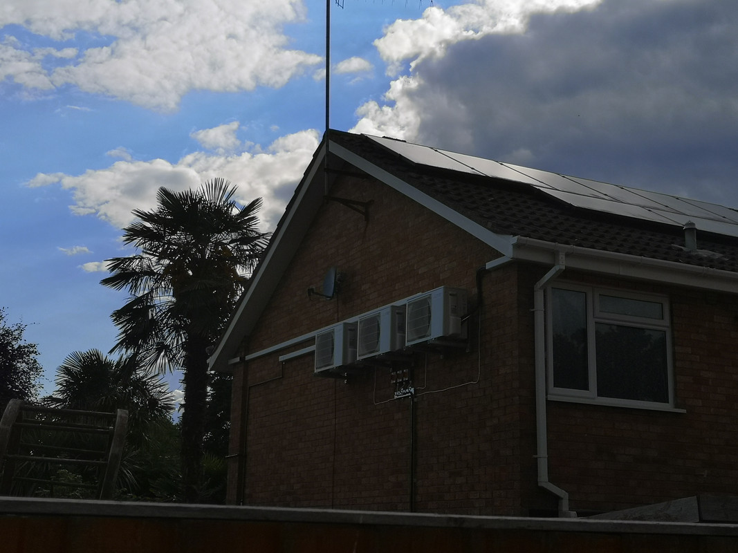

Install nearly finished, all units tested and working, so quiet theyre basically silent. Happy with the overall workmanship. They just miss one final bend in the ducting which they are coming back next week now to put on.

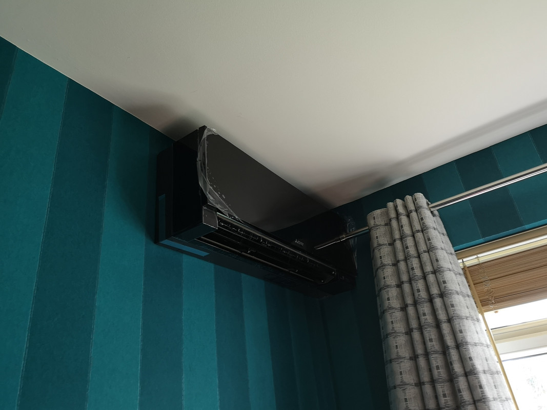

3 units upstairs as per the last post, and they bring the rooms down to temp in minutes.
Its already bliss, cant wait until the middle of summer.
