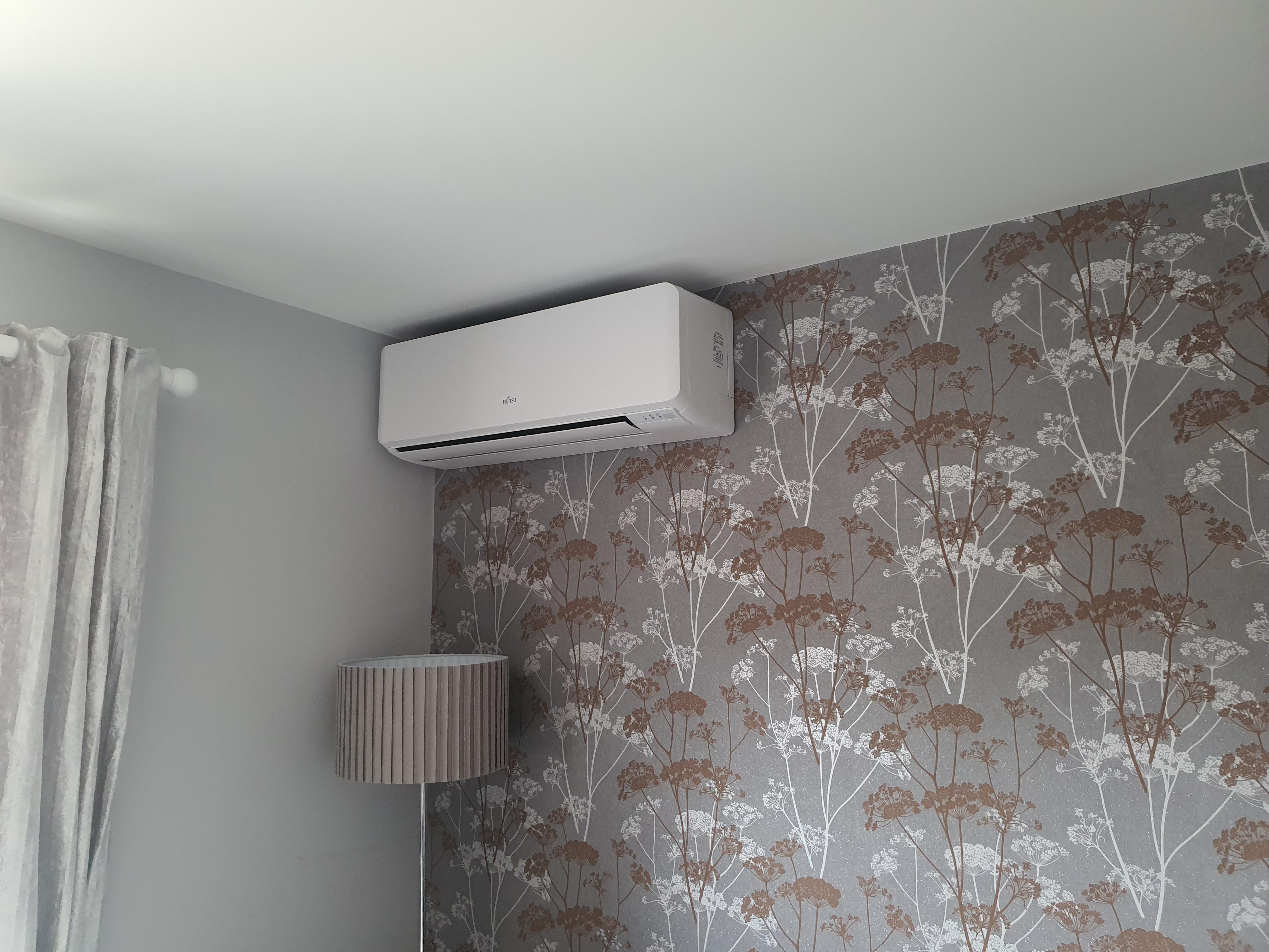

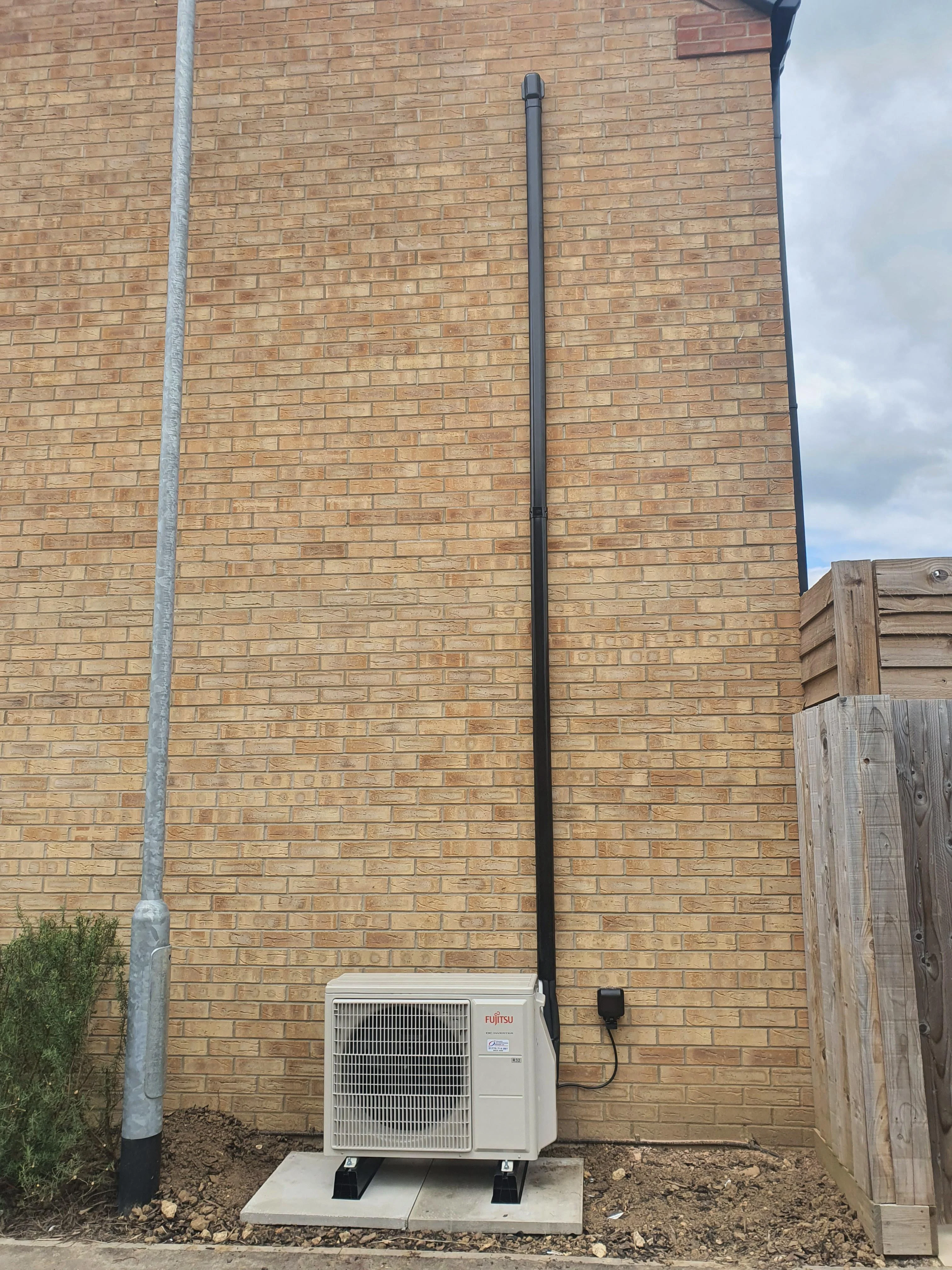

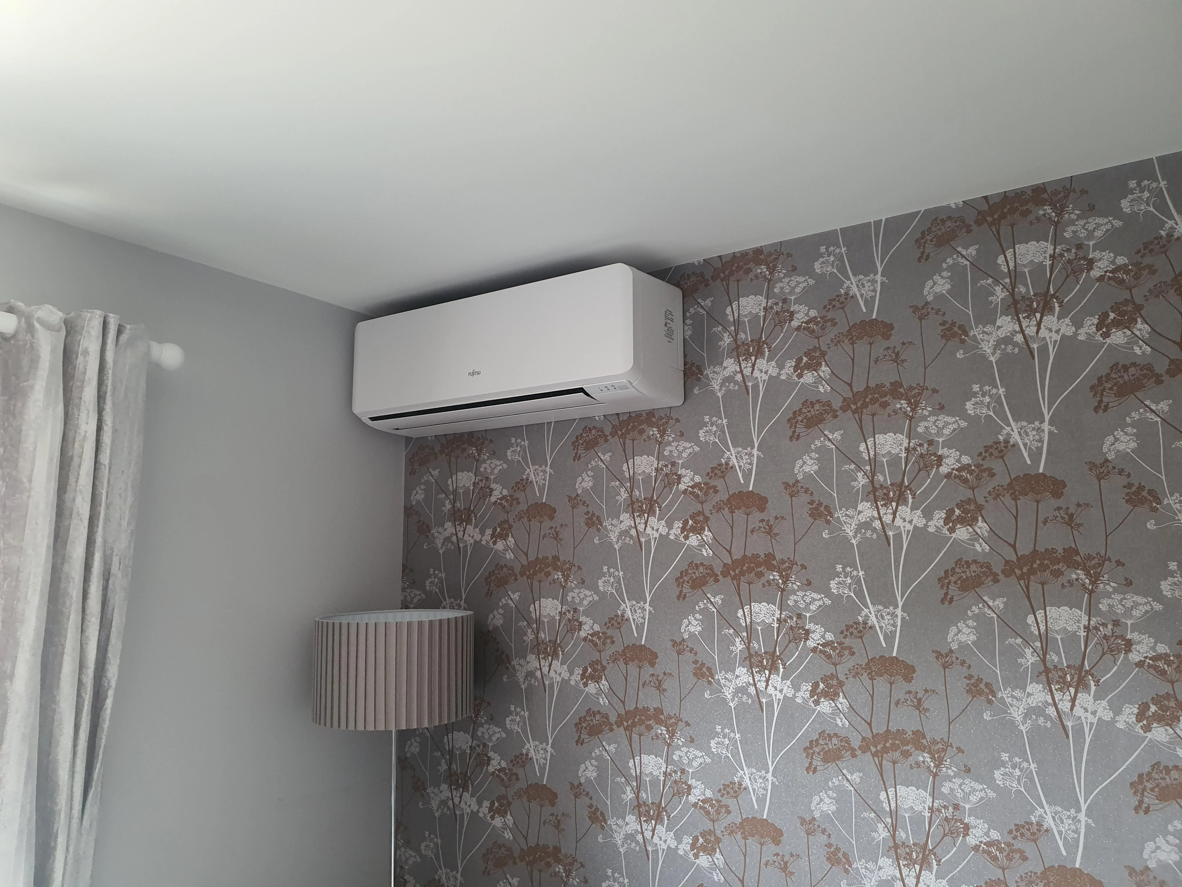

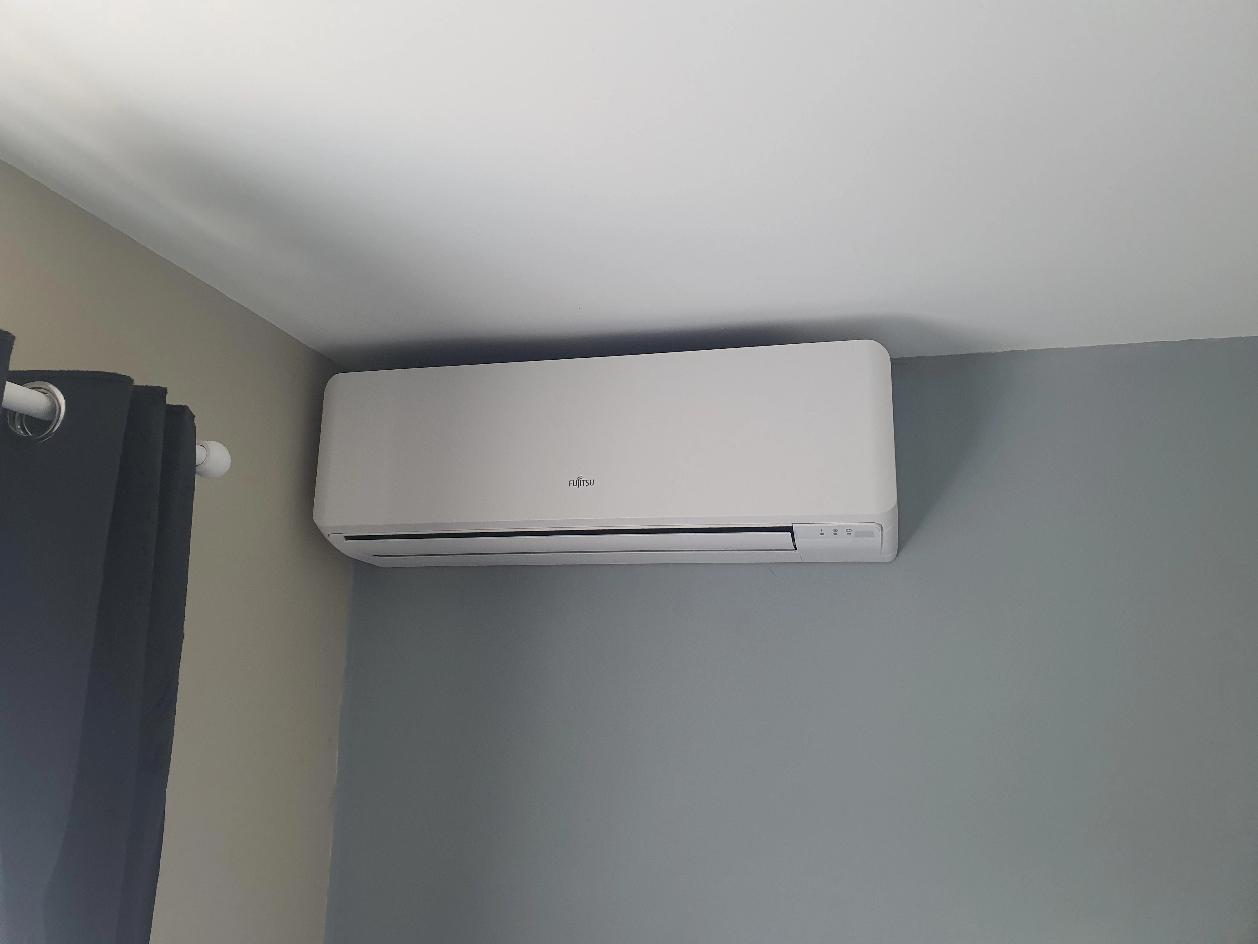

After 10 years of using a portable, we finally have split AC installed. I'm poperly stoked. It's going to bring a lot of comfort for us all, hopefully aid my wife's sleep too, as well as giving the ability to keep windows closed and pollen out for my hayfever and allergies.
Lounge unit
Bedroom unit
Outdoor unit
Really pleased with the install, nice and neat and the guys were very friendly. For anyone in the area I can highly recommend Spalding Airconditioning Services :)
Those indoor units look to high up to the ceiling. it will restrict airflow and you are never going to be able to fully clean the dust from them with a vacuum cleaner (some dust gets through the filter). You also every few years need to give them a wet wash with something like condenside which otherwise you may notice a wet clothes smell when the compressor stops but the fan is still running as condensation will then form on the condenser which has wet dust on it.
Something like this process video I was shocked how black the water was after doing ours the first time, bedrooms are the worst as there is more dust

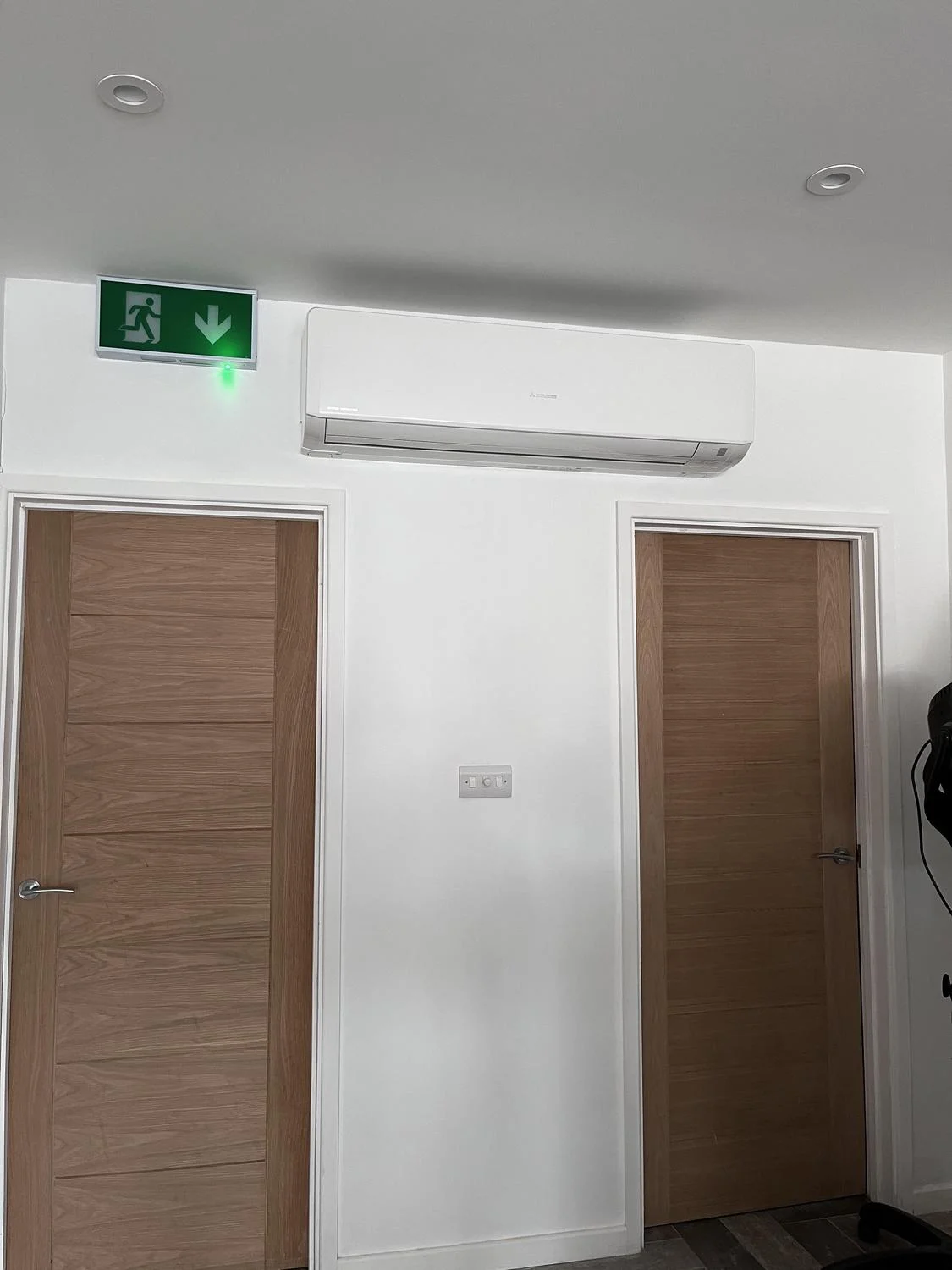

Installed at the salon yesterday, just need the sparky to hook it up before the mad temps coming later this week.
(landlord is replacing the windows and back door soon)
I did think that myself. The installation manual calls for 50mm clearance, I’ve just measured it and it’s 55mm, so it’s within spec at least, but still a little tight for access.
And yes it’s surprising what collects inside these things! Very helpful video that.

It's the outdoor unit on the street or do you have a street lamp in your garden?
