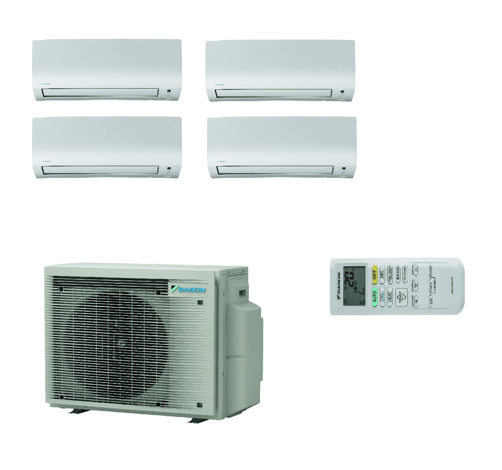

Got my first quote in. For all 3 bedrooms and the living room.
3 x 1.6kw units
1 x 2.5kw unit
1 x 2.5kw external unit
Daikin
£4400![]()
Daikin Air conditioning Multi 1 x 4MXM68A 4 x FTXP20M9 2Kw Wall Mounted Heat Pump R32 A+ 1Ph
Daikin Air conditioning Multi 1 x 4MXM68A 4 x FTXP20M9 2Kw Wall Mounted Heat Pump R32 A 1Ph 240V 50Hz A max pipe run 60M This Kit Includes 1 xwww.orionairsales.co.uk
