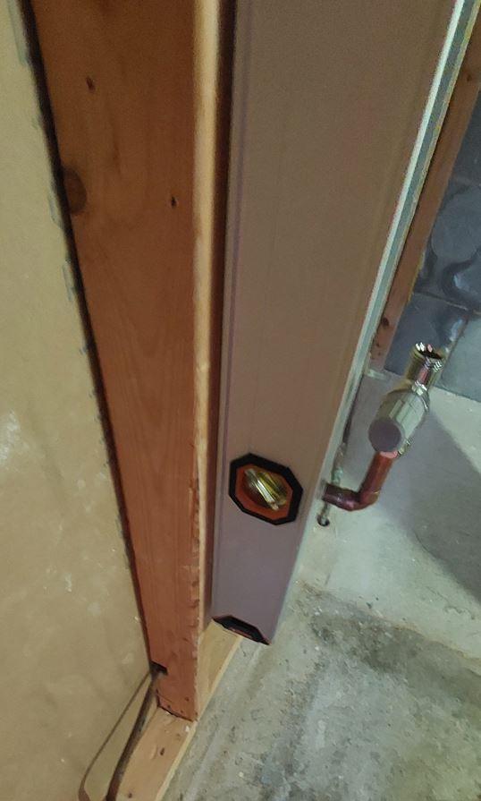

Right, the builder has gone AWOL, sick of waiting so the plan is to have a go at this again, ideally spend the whole of Monday on it...
This is the wall in question, photo skewed slightly as I had to zoom out on camera in order to get a good photo:
This is showing the variance in distance between studs:
When holding board against centre top of the wall, the bottom of the boar is out by this much:
When holding a straight edge/level from top right hand corner, at diagnoal to bottom left corner:
I have reduced that somewhat by using spacers but just want to show what I'm working with here.
Level top to bottom, flush at top of wall, but bottom is out:
Horizontally it's out by this much:
So, my plan is to put new stud work in, I've already got a couple cut, when put flush against the plasterboard on the other side of the wall it sticks out by this much:
Top of stud:
Bottom of stud:
This means I'll have to space out the noggins, right?

Sister the vertical studs and then throw noggings in wherever they need to go. Doesn't need to look pretty you just need to work at pace. Throw in more wood than you need, it isn't expensive and avoids wasting time overthinking.
Ideally you don't want spacers as you'll end up with voids behind the boards. Just batten over the top off.

So on the "top of the stud" pic above, would rip a strip of batten and stick it on the old wood?
Can you afford the space? You could just put a new top piece on over the top of what it is there. It'll cost you whatever the smallest dimension of your CLS is but might make it all a lot easier.
No space to double up, the door is really close to the wall :( don't have the tools to rip a small strip either, it would have to match the contour of the old wood as well, I don't have the tools to do it.
Hence why one option is to take down the entire wall and start again :o
