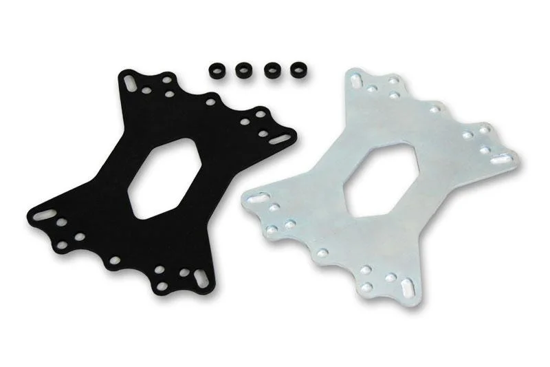

Are you are using the older LTX? You might need a new backplate that doesn't interfere with the socket backplate.
The old backplate:
I only bought the block around a month ago and so am fairly sure it is the newer ltx. I also have the ek 115x true backplate that allows me to apply full mounting pressure.
