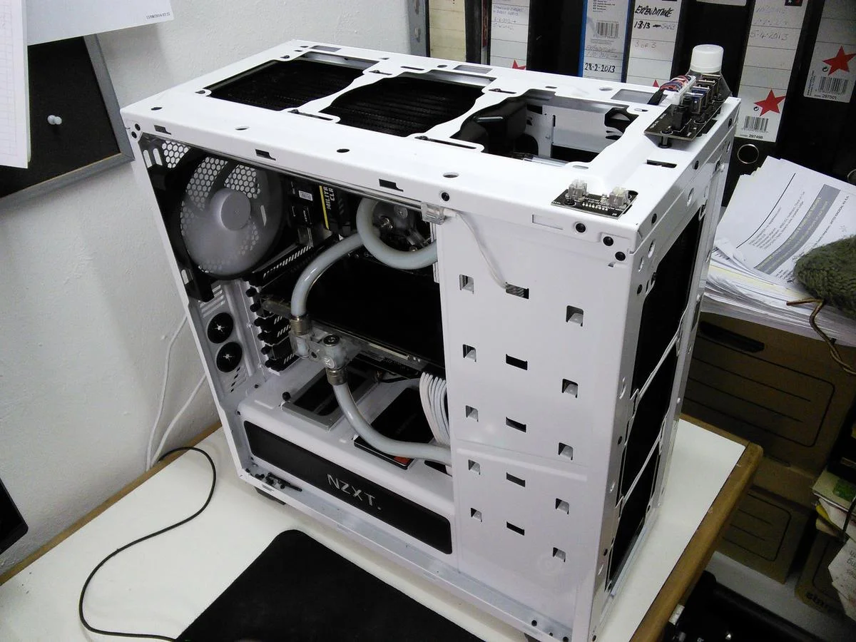

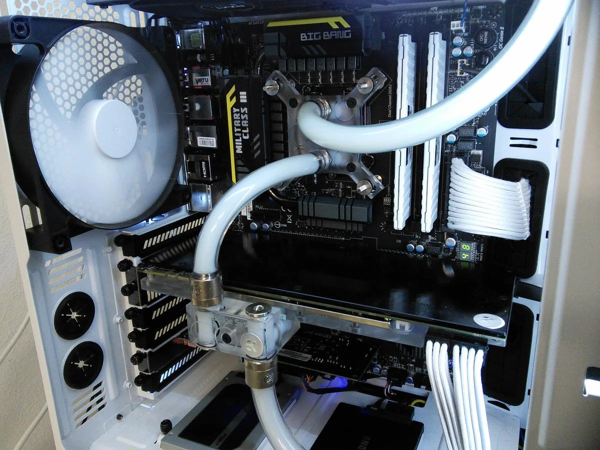

Here are the 2 most relevant pictures:
Currently all the temp testing is being done without the side panels on to ensure maximum airflow.
I think that's your problem... The GTX 780 is heating the water up too much due to the high clocks and voltage and it's having an affect on the CPU temps.
You said the water in your loop is only 25c but I bet that the water coming from your GTX 780 block is a lot higher then that.
I would reverse the loop order.
I highly doubt it is the GPU as when I do all my testing the GPU is idling at desktop. It will sit around 25C when idling and only about 1-2C hotter than the water. When I stress the GPU as well the water will heat up by 15-20C and so will the CPU meaning that under load it reaches the dangerous temps of 95C+. I will move the water temp monitor to between the GPU and CPU so I can directly measure the temp of the water going in.
Rearranging the loop will be a difficult procedure and I am fairly sure that loop order doesn't really matter more than a couple of degrees.
So when you stress test the GPU the water temp increases by 15-20c?
So from my understanding the water at idle enters your GTX 780 water block at around 25c? And then during GPU stress testing it increases to 40-45c? So during high GPU loads the water is exiting your GPU at 40-45c and then entering your 3770k block?
That to me is your problem right there... You need to change your loop around.
Loop order has been proven to not make a significant difference.
The radiator does not 'cool' the liquid in the loop. It radiates heat from the cooling system as a whole.
Radiators feeling cool to the touch may be an indicator, but since GPU temperatures are as expected it doesn't appear to be some kind of airlock or flow issue. Again the fact that the 2550k temperatures are very high would indicate an issue with the block itself.
I would try remounting the block at 90 degrees to what you have it now (ports side by side) and make sure the screws are tightened properly (corner to corner method). When you take off the block to remount it, check the paste spread on the IHS since it might show something about the mount pressure.
Normally with the Ivy I would just say de-lid, but I wouldn't have thought the temperatures should be getting above 60C or so with the soldered Sandy, and that's with the GFX being stressed too.

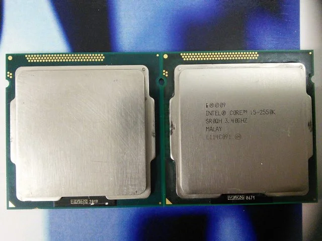

The CPU has been lapped. Poorly.
Or attacked by a gremlin.
Either way it doesn't look good and the temps still suck the big one.

I don't know whether it is the more lapping or the crappy thermal transfer on ivy bridge but it is not good at all. I will contact the guy I bought it off as I was NOT told or shown anywhere that the CPU had been lapped.

A badly lapped one "could" cause this. It will not allow optimum contact as you guys know. Ideally quality lapping should produce a mirror finish effect. From the pic added looks like the previous owner lapped it with a combine harvester. Lol
But even with stock TIM my 3770k never hit 60ºC @ 4.5GHz 1.236v under water. Yeah it'd help to replace with CLU/CLP but I think there's something else having an effect here.
The lapping, whilst not the finest of jobs looks to be pretty even, dont these things just have a nickel coating? If the lapping was on the **** you'd be through in places...
