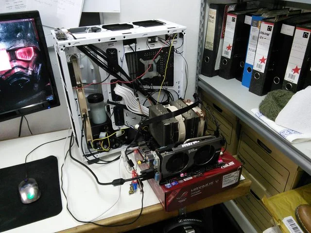

So I set up a ghetto testbench to try the 3570K on air annnddddd it's still shocking.
Fans on full on the NH-D14 and everything at stock and max temps were still nearly 80C. Gonna send the seller a message about what he did to the poor IHS to make it so bad.
Also the 2550K passed 20 runs of Maxmium stress IBT at 4.6Ghz and 1.365v which gives 121 gigaflops of oomph. Very happy to keep the chip.
Contact between the die and IHS must be hosed. Maybe the seller previously tried to delid with a hammer and ended up warping the IHS?
Very possible, however it was not mentioned anywhere when I bought it so I have grounds for a refund.
Tried the ivy with the stock cooler (had to google how to install it cause I have never used one before) and it got to 100 as soon as IBT filled the RAM. nopenopenope.mkv
