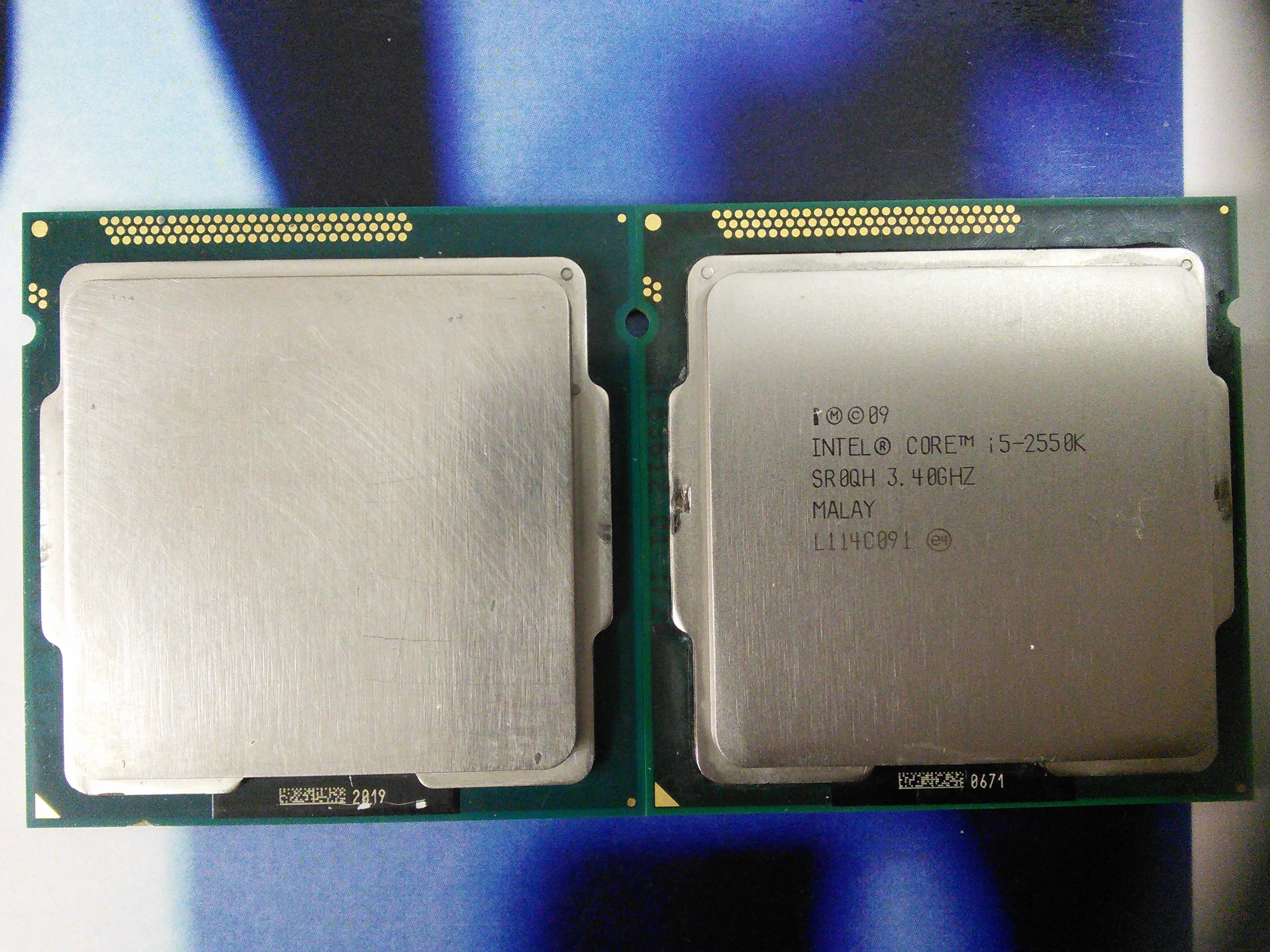

Gonna send the seller a message about what he did to the poor IHS to make it so bad..
Now you know why he sold it, did you post a picture of the IHS as I've not seen one?
His on the left - mine on the right. Quality is a little potato as I do not have a good camera to hand.
