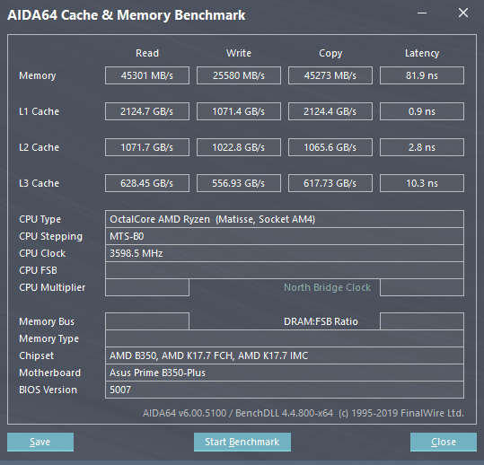

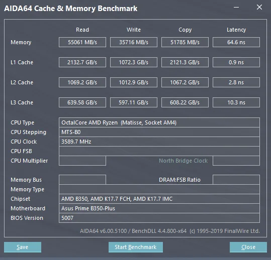

ryzen 3700x on b350 stock xmp 3200 cl 14-14-14-31-97 1.35v
1900 fclk 3800 cl 16-16-16-36-50 1.44v
My first ever attempt at ram oc, just dunno what voltages and timings ppl run these things with ( browsing through the pages of this thread atm).
