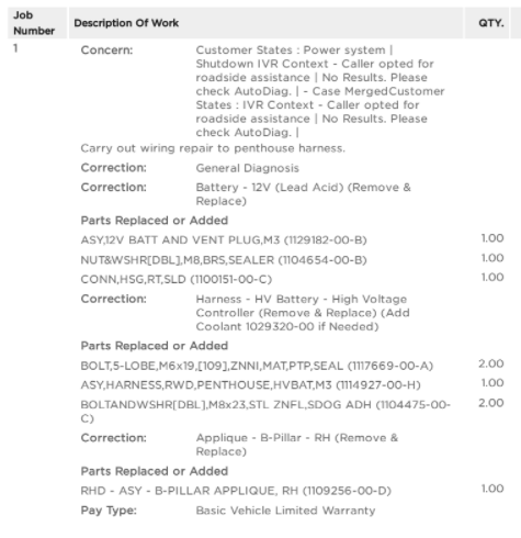

To conclude my M3 SR+ dying unexpectedly, I picked it up last week (would have been the week before but was away) and this is the final invoice detail for anyone interested:
They had a good chat with my over the phone and kept me updated by text and can't fault the service at all. Can't say I fully understand what the issue was past what sounds like a fault with the significant cable ("harness") connecting the battery to the 12V etc, but they spent a decent amount of time diagnosing and testing the repair whilst I had the loaner vehicle so all good.
