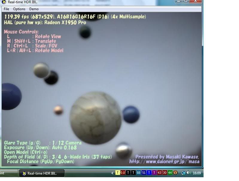

Just tried running everest,
everest and rthdribl
First time I tried it pc crashed like when the games do, second I only had rthdribl running for a about 2minutes.
Gutted if its the card, was fine running HL2 few weeks back.
see how long it can run this dribble program for :) if it cant do it forever, then i'm afraid it does sound a lot like a card failure, if so, you need to start looking at warranties and what not
