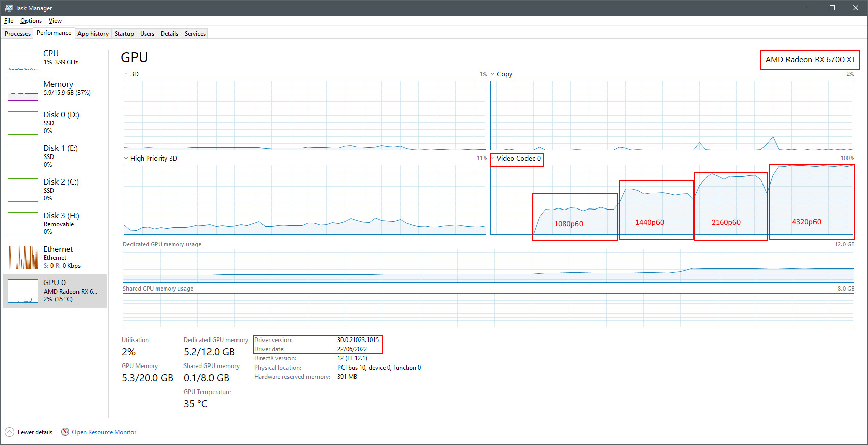

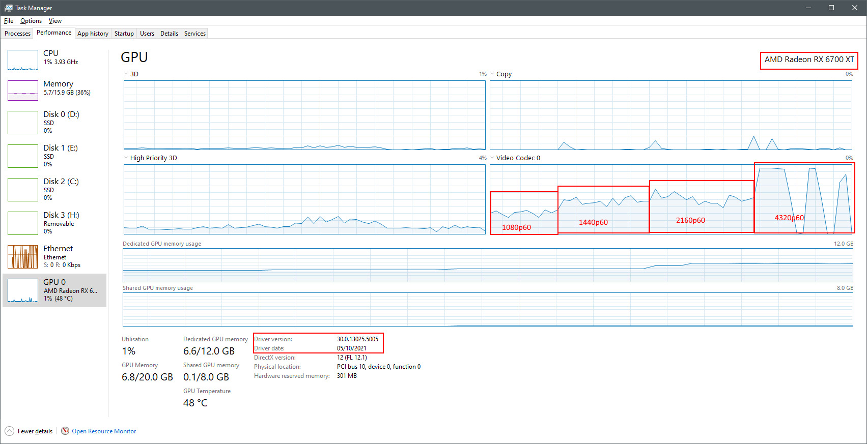

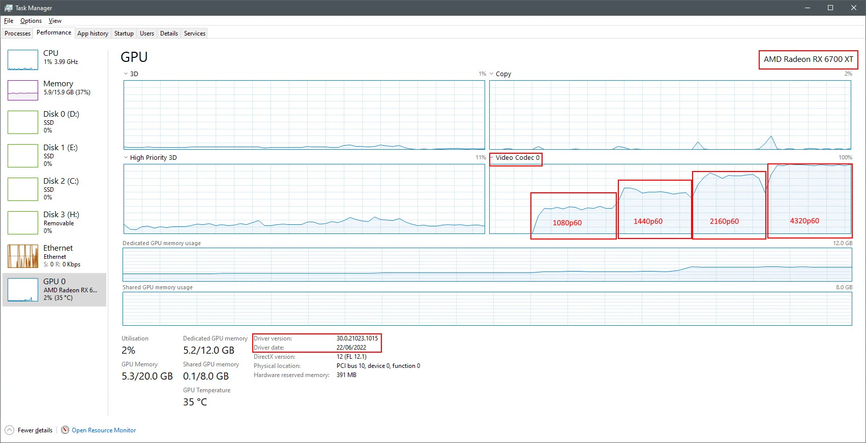

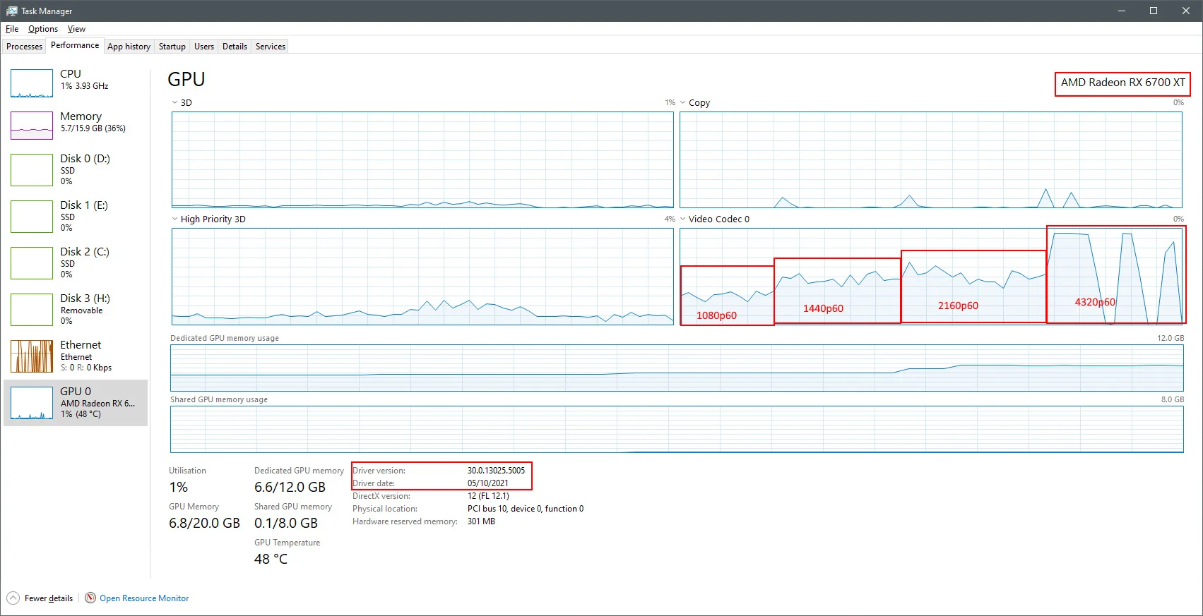

Has something changed in video playback to make the newer drivers perform worse?
I noticed in the latest drivers that watching 4k youtube videos is worse than previously, video stutters and dropped frames.
So to test I started installing random previous drivers to try and see if something had changed.
Drivers 22.6.1, 22.5.1, 22.3.2, 22.1.2 all have issues with certain 2160p (4K) content on youtube.
Jumping all the way back to driver 21.10.2 and the same video plays fine at 4K.
Checking the 'Video Codec 0' graph in task manager shows basically half of the utilisation in driver 21.10.2 compared to the others I tested.
8K video is basically unwatchable with any of the tested drivers but is slightly better in 21.10.2.
I only tested the drivers listed, not all the ones in-between, so not sure exactly when this changed but can any one else test and confirm they see the same?
Tested using this youtube video (but happens on various videos tested)...
Win10, 6700XT, 3900X, using firefox.

@AMD_Vik / anyone else who can test/confirm?

Can you let me know which GPU you're using?
@melmac ,
thanks for the info. tbh thinking of it now I had read in this thread about the Quest issues but not put 2+2 together, as not having a Quest I kind of skimmed over those posts.
21.10.2 are the latest drivers I've tested that seem to not have the issue, 22.1.2 does have it but not tested (and probably not going to) all the drivers in between to find the latest working one.
I've just gone back to 22.6.1 as don't really want to be on a 6 to 8 month old driver for now
I'm already dropping one of my monitors from 120Hz to 60Hz to stop the GPU mem clock always running at max, so watching the odd youtube vid at 1440p instead of 4K I can live with for now. :/
@AMD_Vik ,
As above, 21.10.2 is the LKG driver that I tested.
The other drivers I tested where 22.6.1, 22.5.1, 22.3.2, 22.1.2 and all have the issue.
I haven't (and probably won't) test any more drivers between 21.10.2 and 22.1.2, though I have read that 'maybe' the last December 2021 driver delivered via windows update is ok but I've not tested.
Using a 6700XT, Win10 Pro x64, latest updates etc.
