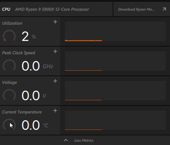

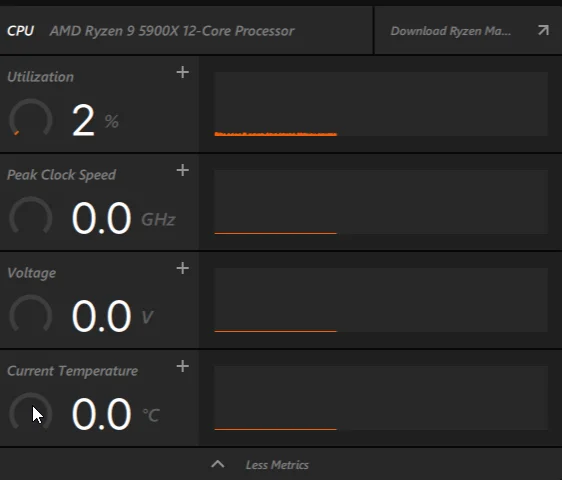

anyone else's CPU showing 0 stats since new driver?
