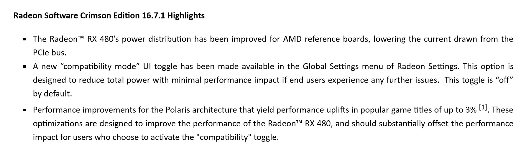

In the previous Radeon Software Crimson Edition 16.7.1 driver the "Restore Factory Defaults" option under Preferences of Radeon Settings Software would not set the "Compatibility Mode" UI toggle to its default "OFF" value. This is fixed in the Radeon Software Crimson Edition 16.7.2 driver. The "Restore Factory Defaults" options resets all Radeon Settings to their factory default values.
