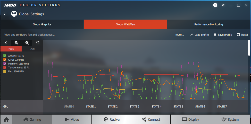

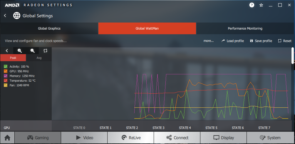

I'm having a problem which I'm not sure if it started with Adrenalin or a previous driver:
Assassins Creed 3 is giving me low FPS (30 - 50 @ 1650x1050) and low GPU utilisation (30%?) along with low GPU clock speeds (650mhz) on a 290x, Windows 10.
Has anyone else encountered this? Card clocks up fine in benchmarks such as unigen valley.
Green line shows utilisation all over the place, orange line is core clock speed, temps are fine, not throttling.
Edit: Just to add, Adrenalin was installed after DDU, ReLive not installed.
Edit 2: Seems like it's the usual reason for low GPU utilisation - CPU bottleneck. The game is loading up 1 core to 100%, apparently 5820k @ 4.4ghz just isn't enough. :rolleyes:
AC3 FRTC OFF, Chill OFF.
AC3 FRTC ON, Chill OFF.
