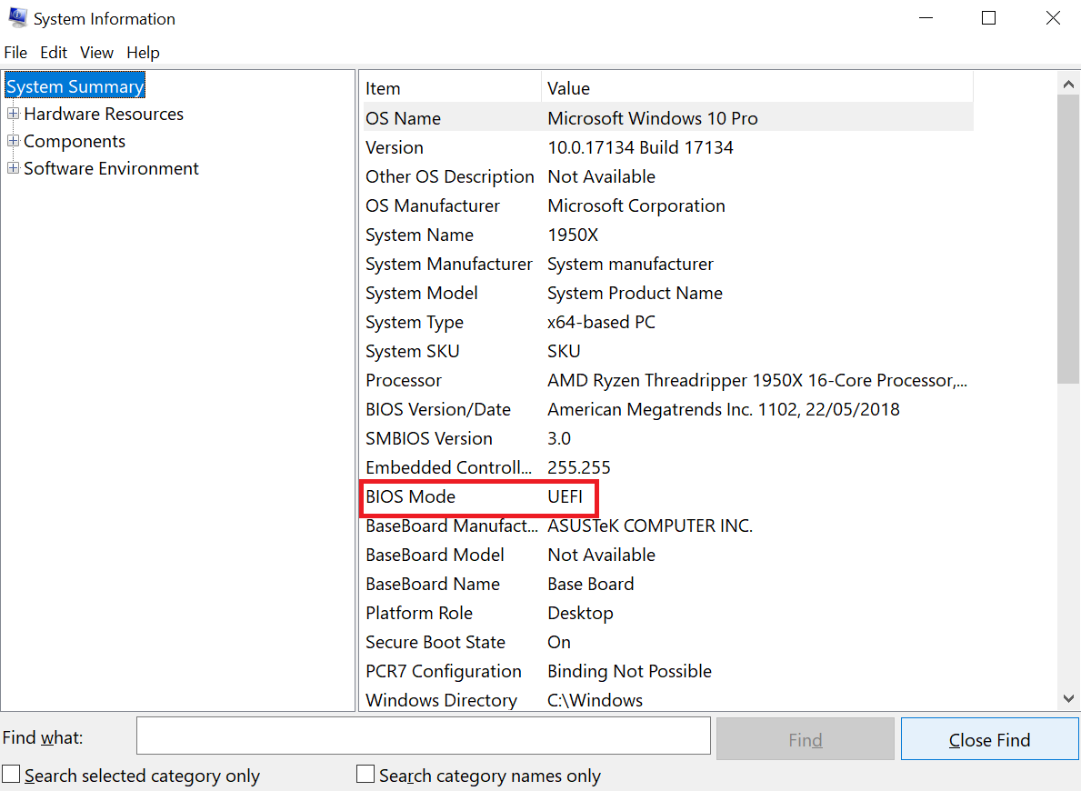

Can you type system information into the Windows 10 start menu, hit enter, and let me know if you see the word UEFI or Legacy as shown in the example below?

Okay, try this.
1. In the BIOS, navigate to the Boot menu/option and set it to Windows UEFI mode. It should be defaulted to Other OS or similar. Save and exit the BIOS.
2. Install Windows 10 using your installation media.
3. After Windows installation at the desktop, run system information and check that it lists BIOS as UEFI mode and not Legacy.
4. Update Windows 10, installing all available updates, once finished restart.
5. Install 18.10.0601 Chipset drivers
6. Install Adrenalin 18.5.1 drivers and restart.
Let me know if you still experience the green screen.
Okay, try this.

Try in the BIOS, under Boot > Secure Boot > OS Type > Windows UEFI Mode. Example screenshot below (albeit from a Asus motherboard)
What motherboard are you using?

Ok, so I have enabled secure boot and re installed W10.
Under System Information it now says UEFI so all done succesfully.
