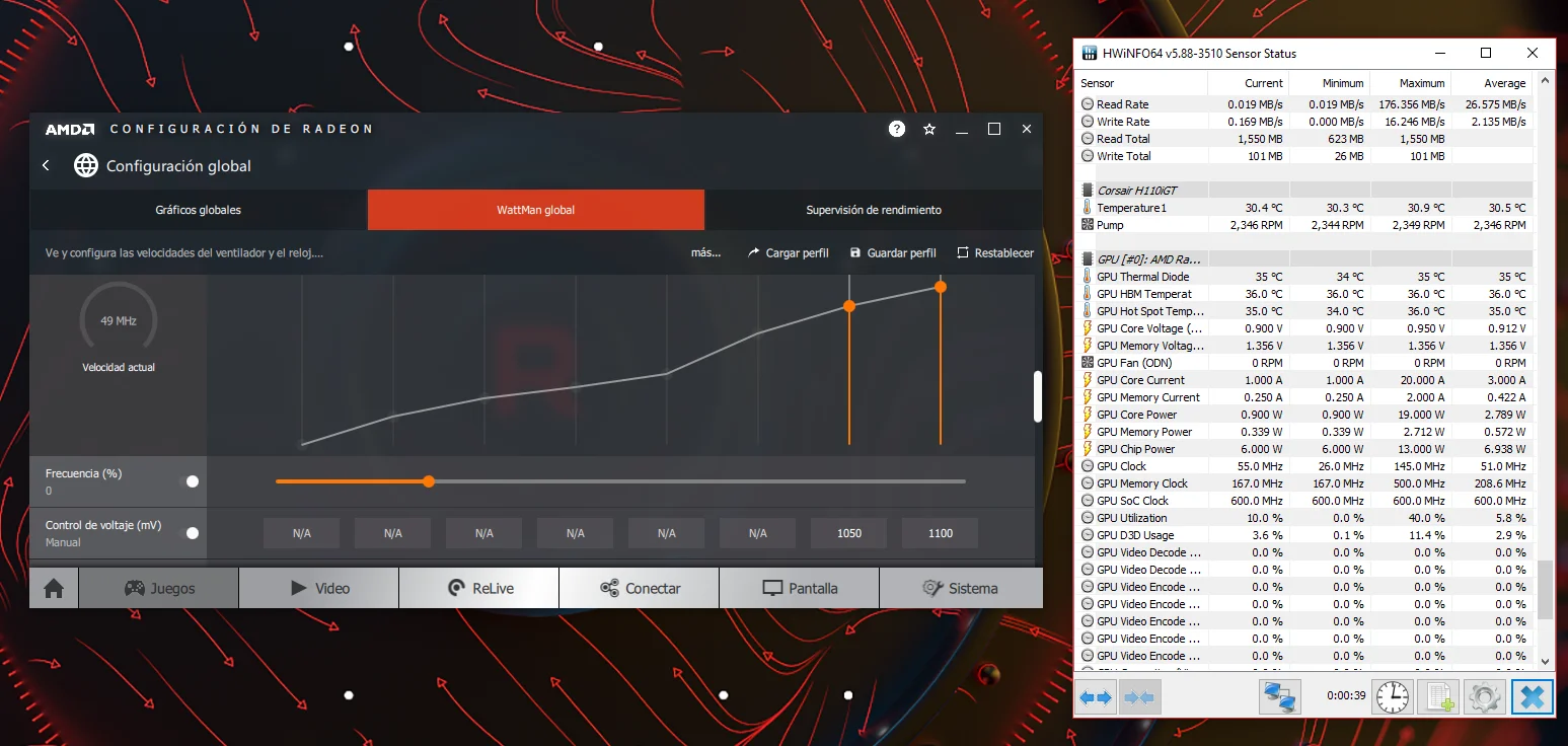

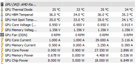

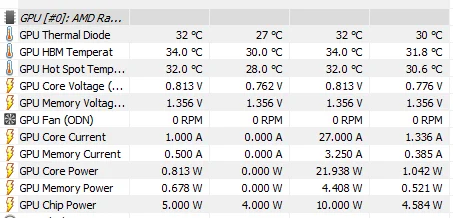

Hello,
Please @LtMatt if you are so kind to test this
Voltage on idle for my Sapphire Nitro+ 64 on the default balanced profile in wattman:
Then I set 1100mV on both P6 an P7 and restart the system, voltage on idle is 0.9V now
Why doesn't it idle at 0.762V anymore? Thank you :)

P6 has to be lower power than P7
Why you bother about voltage? As you see the chip power is just 6W it cannot go lower.
Because I get a little bit higher temps, and because it does not happen when undervolting with MSI AB, in fact MSI AB applies undervolt on every PSTATE so on idle it stays at ~0.638V
I thought it could be a bad windows installation and even did a fresh install and did not install AB this time but it happens the same :(
I'd like to forget about using AB, but I won't until I can fix this bug.

Reproduced, looking into it.
