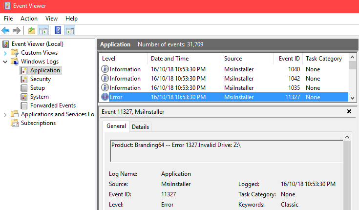

Product: AMD Problem Report Wizard -- Error 1327.Invalid Drive: Z:\
HKEY_CURRENT_USER\Software\Microsoft\Windows\CurrentVersion\Explorer\User Shell Folders
