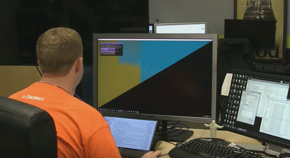

Gif of the pcper test. Frontier is not doing Tiled rasterization

TBR requires hardware/architecture compatibility to work. As far as I know the 2 fundamental hardware parts needed are having a large L2 cache, plus allowing the L2 cache and ROPs to communicate directly.
Vega claims to have both of these features. And also that video of the PCper dude testing the rasterisation proves the large L2 cache part, as the sections of triangle it's drawing are physically larger than Polaris, Fiji, etc. draw. And this is because the size of triangle-section is limited by L2 cache size.
