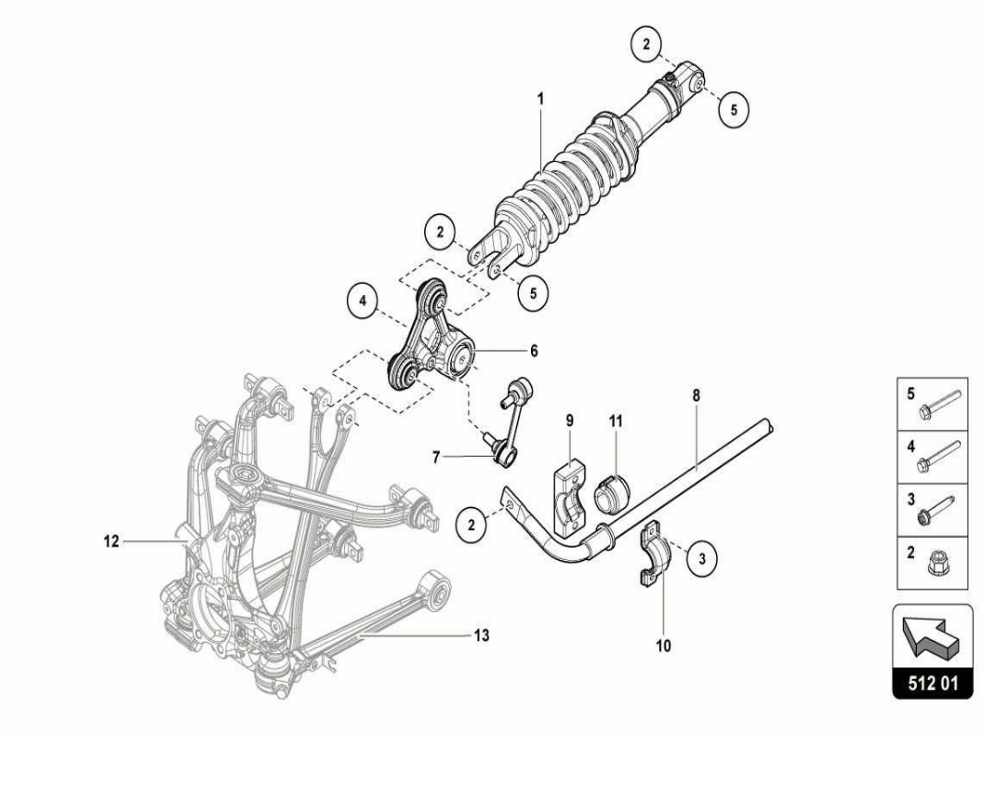

What's the benefit of the dampers being angled rather than almost vertical, is it just a space thing?
It uses push rod suspension so its just how they've oriented it to connect to the rocker assembly.
Tech diagram to help visualize it all:
2021-08-29-22-52-27-Eurospares-are-the-worldwide-number-1-supplier-of-the-complete-range-of-new-and.png
Not much good if you want a boot either. Main benefit is you can fit a bigger damper in. I’d argue there’s no significant unsprung mass benefit as you need to add a rocker.
