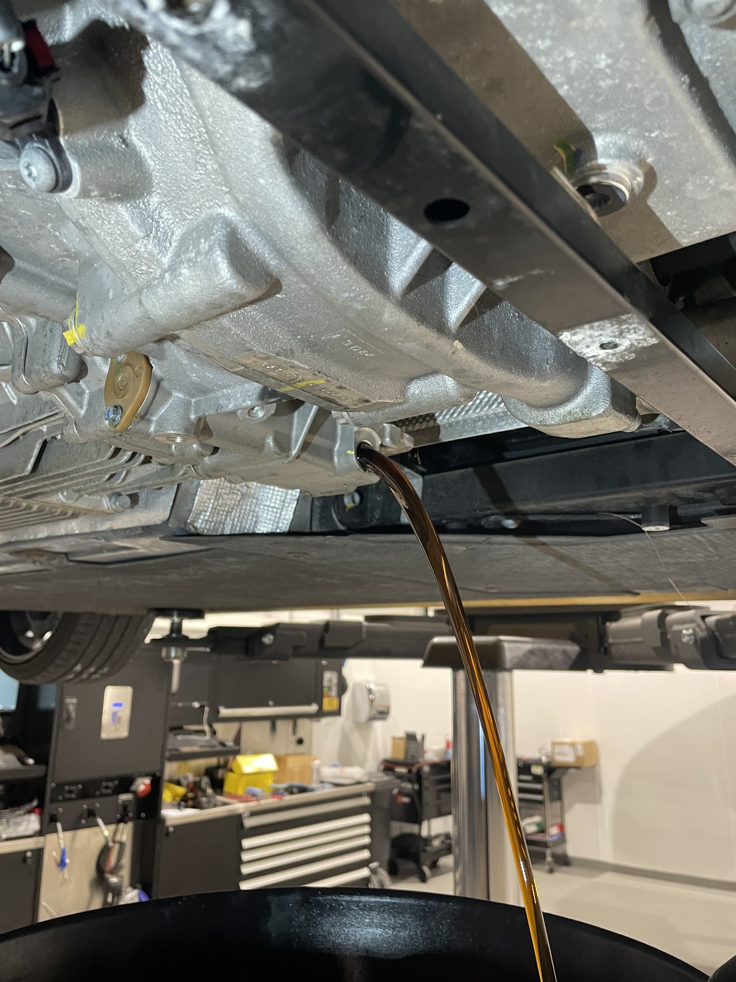

So car was in for a service and with it the repair on the leaking gearbox.
Asked them to get some photos of it, and they did!
Into Lamborghini Birminghams new state of the art service center. You may spot some very nice rare beauties on the ramps also.
Up she goes!
First thing first, lots of gearbox oil needs to be taken out.
Quite a lot....
