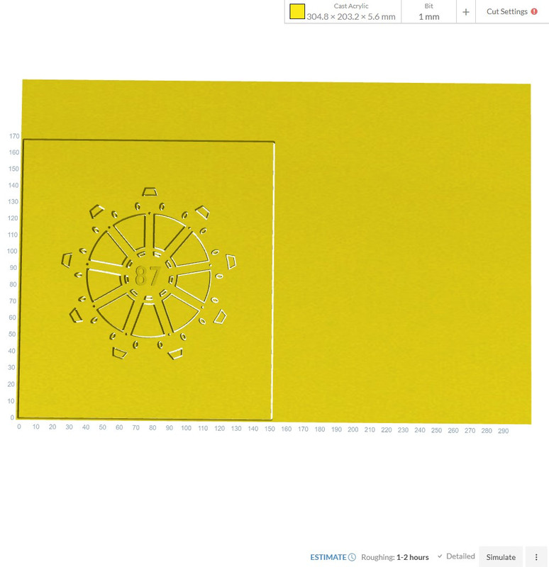

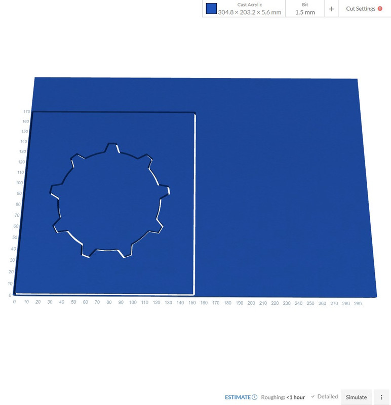

Hey all. So I started work on one of the side panels last night. I was going to cut all the way through, but then had worries about how to assemble it. So I am instead going to carve in the logo, then cut out pieces of yellow and insert them.
So aye, it should look something like that.

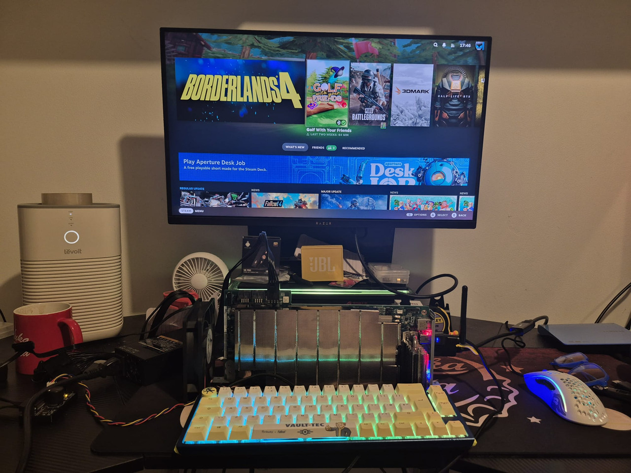

OK so obviously I have been distracted, but today I got the wifi working.
Its the same as a Steam Deck, apparently.
Unfortunately I did not install the game yet as I forgot my other desktop was downloading a game. But the principle works haha. I also asked a guy in Russia I think to test FO3 (he uploads lots of videos of the BC 250) and he said it ran beautifully at 4k. Amazing :D

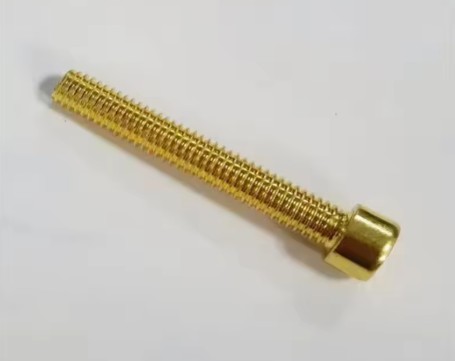

Edit. I've now ordered the bolts. Gold ti coated M4x12.
OK so I have ordered all of the plastics. I ordered 6 sheets of blue in 5mm and two in yellow in 3mm. So there is a spare there in case anything goes wrong. I hope not lmao, set me back £73.
These are the Ti coated bolts I have ordered. Should be here next week somewhen.
In 12mm, IIRC.

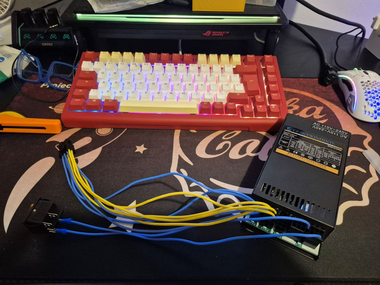

Oh and I rewired the PSU a bit. The 8 pin PCIE (3 lives 5 grounds) has been done but was not easy as the connector on the PSU end is only 6 pins (cable doubling is one of my pet peeves). So I had to buzz the 4 pin EPS (that also doubles into an 8) and send two grounds into that connector, removing all of the wires I did not need. Way tidier.
Tomorrow I shall continue wiring. I need to remove 22 of the 24 pin connector wires and fit a proper switch. Right now I am using an EVGA PSU starter thingermajig.

OK all the PSU wiring is now finished :)
Am very, very happy with that. Wish the blue was darker but was the only blue silicon wire available.
Joking dude. IDK if you have ever used silicon wire, but it is amazing. No bending or trying to train it, it just flops around. If I braid them it will lose that trait.

All of my braided ATX and PCIE wires were silicone. The RGB stuff where I had to get four wires in a sleeve were MDPE because it's really thin.
