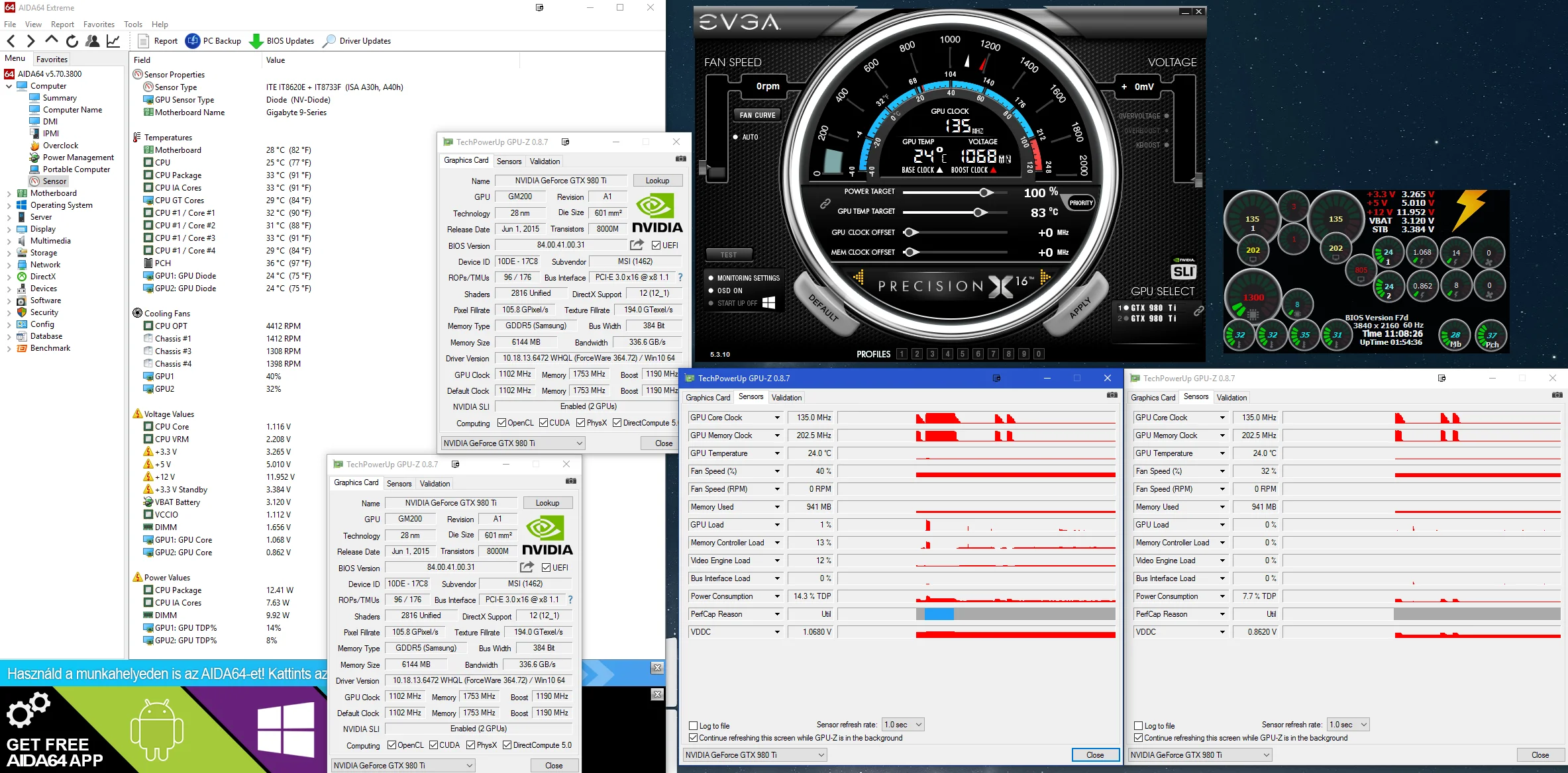

I take it you are using the standard auto fan profile. Don't!
This is currently the fan curve i'm using, 980Ti classified on air (with other info)
Thats better. Try adding load to the card and monitor temps / power etc. The built in GPUz is a bit of a weak test as it does not use full power - gaming and certain tests will soon ramp up temps
Must be a difference in coolers or something, but those fan profiles are brutal! there's no way I could sit with that blasting in my lug hole!
haha. I'll give yours a shot.
Are you running stock and have you monitoring temps / clock speeds? It may throttle back when it gets to ~70c+ (the reason for my brutal fan profile)
edit - Thanks Telecaster. Yours seems to be fine at least with a loop of Heaven 4
I think my card doesnt throttle though because of the unlocked bios I am using (I have also changed power tables a bit)
I notice your running the mem speed up to 500, not tried that, mine is at 300. They seem more fussy about core speed, can only get about 90 whereas the 970 I got 150
It depends what stock settings are too I guess, on the classified its 1190mhz default on the core. They do seem fussy about the core but it doesnt offer a great deal of improvement to be honest, not at 20 or 30mhz higher anyway. When I wack up the memory to +720 it yields better results than say sticking with +500 memory and +125 core (1530mhz) Its also a lot more stable.
