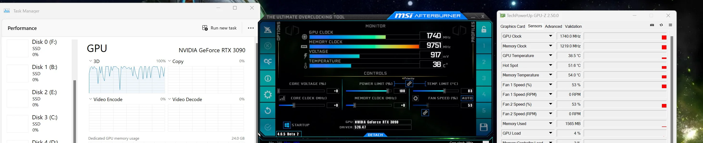

I was on 526.47 and clocks idled normally after startup but stayed high after running anything significant. Also noticed task manager showing 100% GPU usage for no reason. Never noticed this before today.

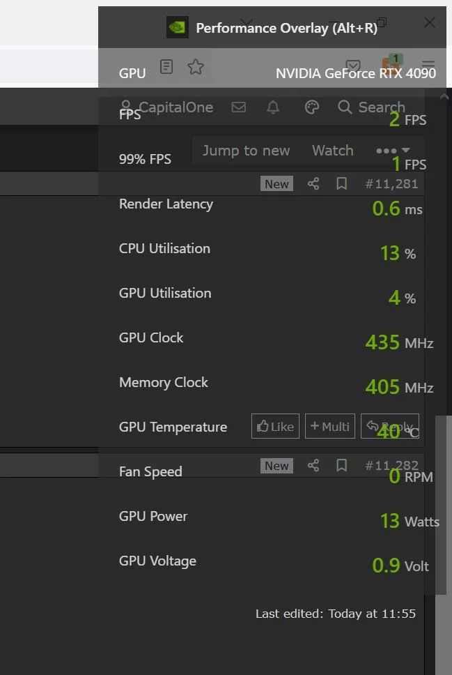

I'm on 527.47 here - I am getting crashes in MW2 (and was on desktop until I set the Link State power saving to OFF) and this is me on the desktop (they bumped up a little when I run the sniping tool) if that helps.
