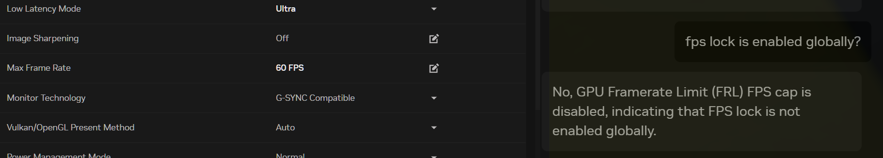

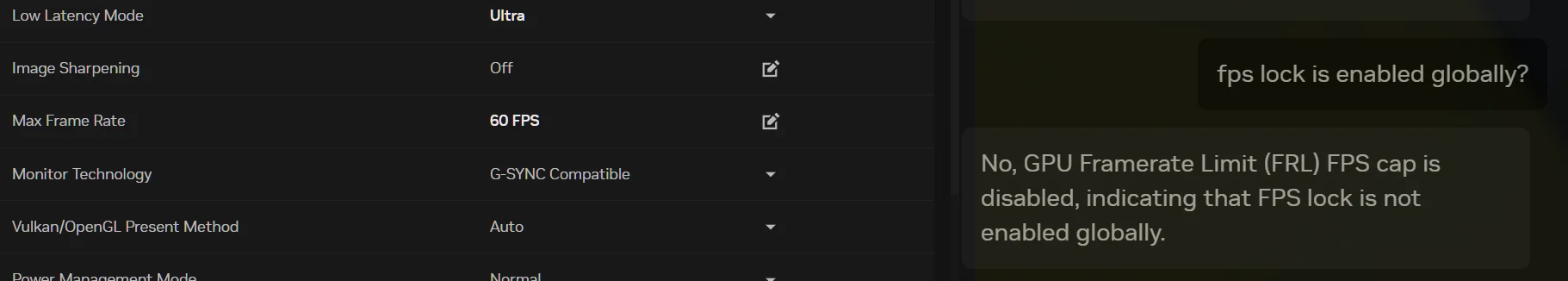

is Project G-assist dumb? or is FRL something different to "max frame rate"
is max frame rate and FRL the same thing?
No, they are not the same thing. Max frame rate is not mentioned in the provided information, but GPU Framerate Limit (FRL) FPS cap is disabled, which means that the maximum frame rate is not capped.
so you dont know what Max Frame Rate is?
I don't have information about your system's maximum frame rate. However, I can provide general information about NVIDIA GPUs and gaming optimizations. Would you like to know more about that?
its a graphics setting in the nvidia control panel though?
The information about maximum frame rate is not provided in the current prompt or previous information. However, I can tell you that the NVIDIA Control Panel is where you would typically find settings related to frame rate and other graphics settings.
I don't get it
wow this thing is so dumb...

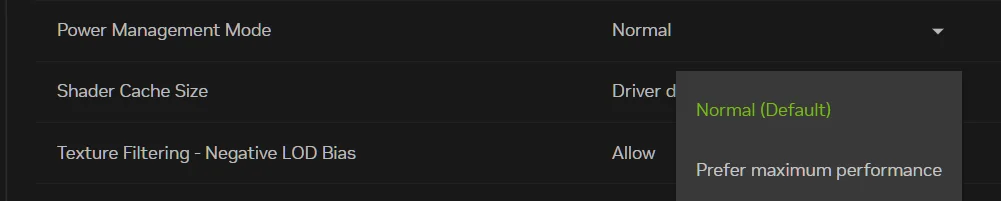

how do I enable to perf per watt setting manually?
Do you want to enable maximum power efficiency with a minimum framerate of 60FPS?
Please respond with Y/N.
surely its the same thing as power management...
or are these supposed to be special options only the bot has access to? or did someone just code the name of the settings wrong?
