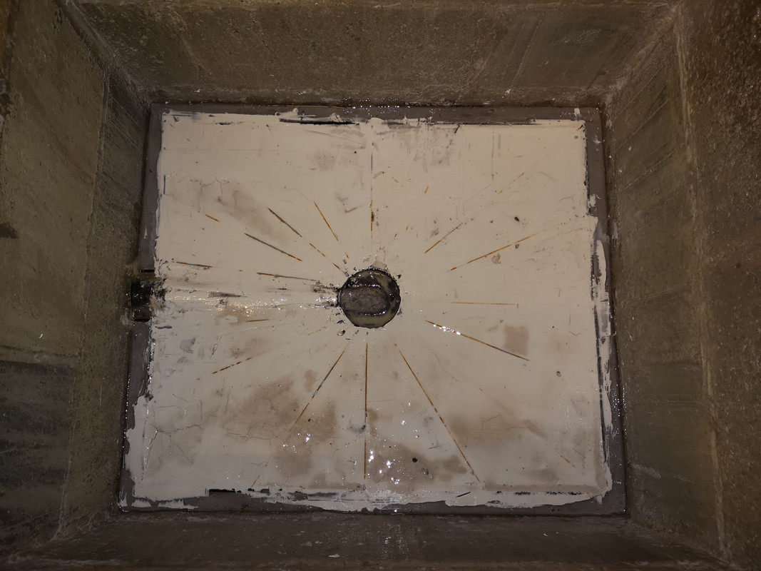

Got the base in and tapered down to the middle the last few days, have just finished the 2nd layer of epoxy over the top of the base just to be able to give it a very rough sanding and then get the fibreglassing done next week.
I may have accidentally'd..
A Hi Utsuri (black and orange) and a Tancho Kohaku (the one with the dot on it's head).
The little orange and black guy already has got used to the pond, it seemed it was getting a little starved, so it's been chomping at some food already! The Tancho got a little freaked by the large fish (I have a grass carp and a large rin chargoi that was busy sunbathing in the lillypads.. this takes no effort to be wedged in and in the warm stiller water in the lilies..
Weather looks good for tomorrow with no rain so will get the media box fibreglassed.
Sanded it all down to get the mechanical key in the resin and edges, as well as on the inlets and outlets.
Then stage 2 can begin :D
Today was absolutely perfect weather for fibreglassing. Yes it is inside a shed but glassing while the air is humid just makes things more unworkable.
Anyway we got to work....
First was the "technical parts" the glass ledge and the pipework.
The rest of the easy bits were done and then all sanded to denib any sharp edges that when flow coated turn into razors.
It was then flowcoated in lovely black. Nice and waterproof.
Goiong to leave it to dry a day or 2 then get the glass window in and sealed.

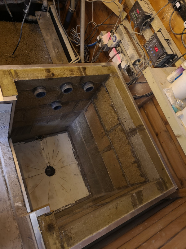

So busy day. Progressed as far as possible with the existing filteration in place, however now need to widen the "old pit".
The drum and old bio chamber.
First thing first, empty the media into floating nets to keep the bacteria alive and provide "some" benefit.
Next the protein skimmer taken out
And the drum removed.
The old bio chamber was then taken to with a circular saw and angle grinder.
It was rotting apart in places so while in theory the fibreglass strength would have kept it together, probably good that it has been dismantled.
Next removed as much of the old electrics as possible, then mark up the pond overflow line and the working water level lines with a laser level and tape.
Finally, spray over the tape and remove to know the exact working levels for the next parts of the project.
