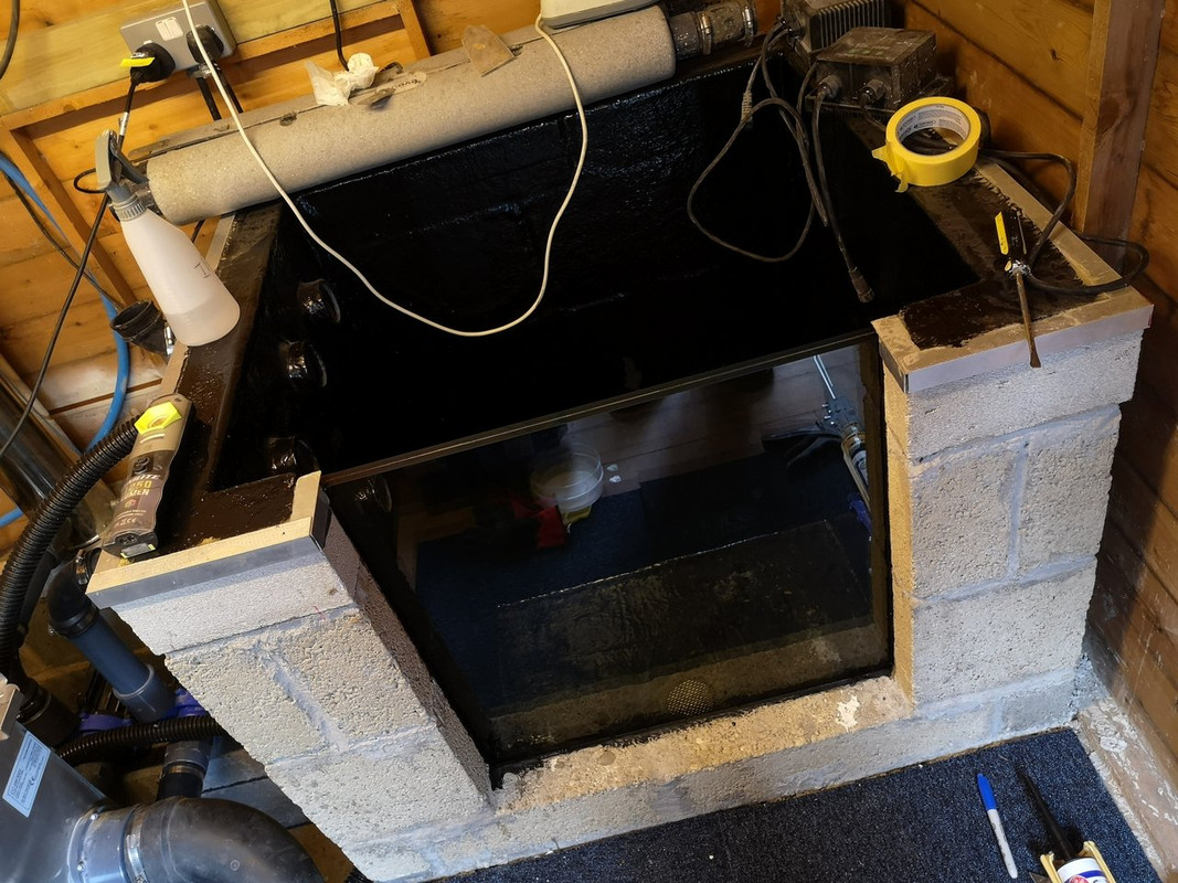

Glass turned up and sealed in, 2 full tubes of CT1 holding this in :D

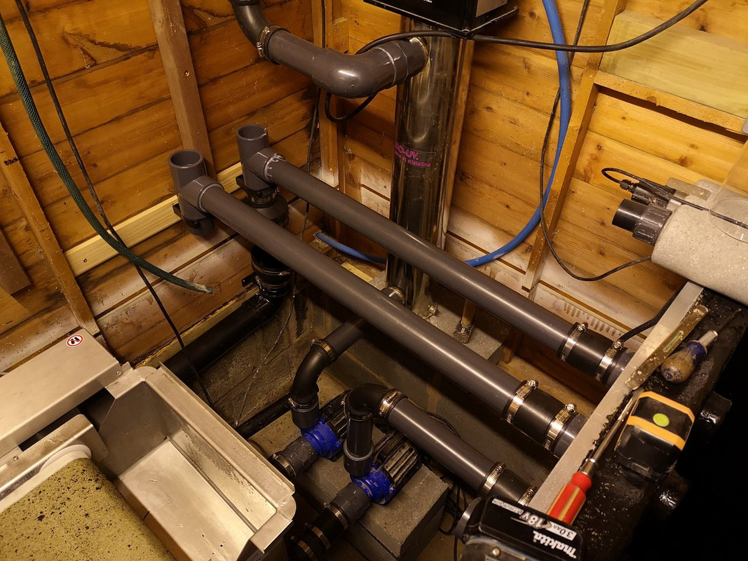

Return pipework nearly finished.

Got the drain pipework plumbed in today, and gave the new bio chamber a test fill to leave overnight and check for any leaks.
Boring video of a box filling with water lol.
