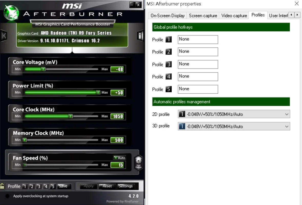

I use MSI Afterburner and 2D/3D profiles to undervolt. No need to mess about with anything, it's applied automatically.

Running Aidia 64 now, 100% GPU load and the nano at
-36mV
+50 Power
1050 Core
500 memory
96% Fan speed
and its at 80 degree, if i swap it to default fan map it goes to abotu 82% fan speed and sits at 84 degree.
How hot do you push these cards? Should I try increasing the clock next or see how low i can push the voltage first? Can't find nay overclocking guides my voltage is reduced rather than added when the increased clock causes instability. Loving the chance to learn, thanks for the help.

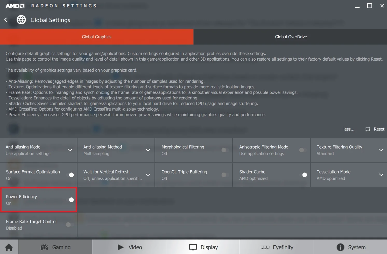

Can you try updating to the Crimson 16.3 driver? Run DDU first to uninstall your current drivers.
In Radeon Settings disable Power Efficiency and see if that has any effect on the issue.
It looks like is not there on R9 Nano. Mine doesn't have that Power option and I use 16.3 after uninstalling 16.2, DDU and clean install.
Done the driver thankyou. Nano doesnt seem to have a power efficiency setting though.
Thanks, I'll look into this.
The power efficiency setting does not apply to the Nano and R9 2xx.

i've got afterburner set at +50, how do i know if clock is fluctuating?
So running the overlay like you asked, sits quite happy at 1050 core clock with no fluctuation.
