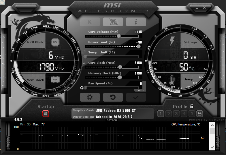

Ok, will give this a solid 24hrs first to ensure stability. What should I aim for?
Do you mean core voltage? I don't think there is any memory voltage control on Navi.
Try 2150Mhz at 1.150v. I was almost stable at that voltage, but had to increase it two notches to 1.168v. Ended up going to 1.175 to allow a little headroom on stability.
That didn't answer my question. :p
This is what I have set atm, given it 20mins in Heaven and been ok. Needs further testing obv
Boosting to just over 2100Mhz with the above settings @LtMatt
edit - Not stable I don't think
Yea Heaven is useless for stability, may as well just run Notepad.
You'll need a demanding game, something like Far Cry 5 at a constant 99% utilization for an hour or so to truly test stability, once the card has had a good amount of time to heat up.
