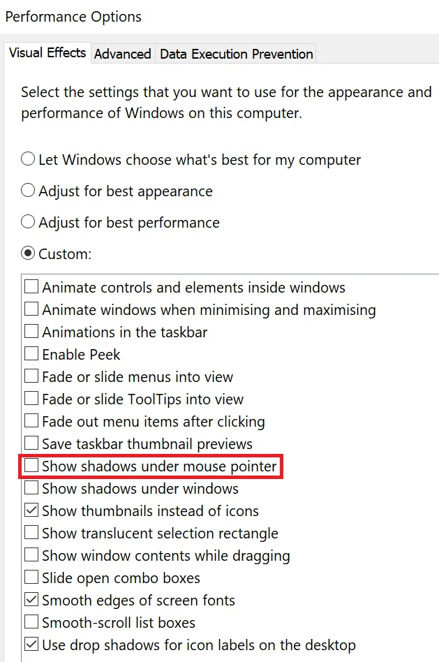

Could you try changing your mouse polling speed perhaps? Make sure enhanced sync is off, anti lag, freesync etc, see if any of that helps (unlikely).
One other thought, make sure this is disabled.
That's all I can think of for now.

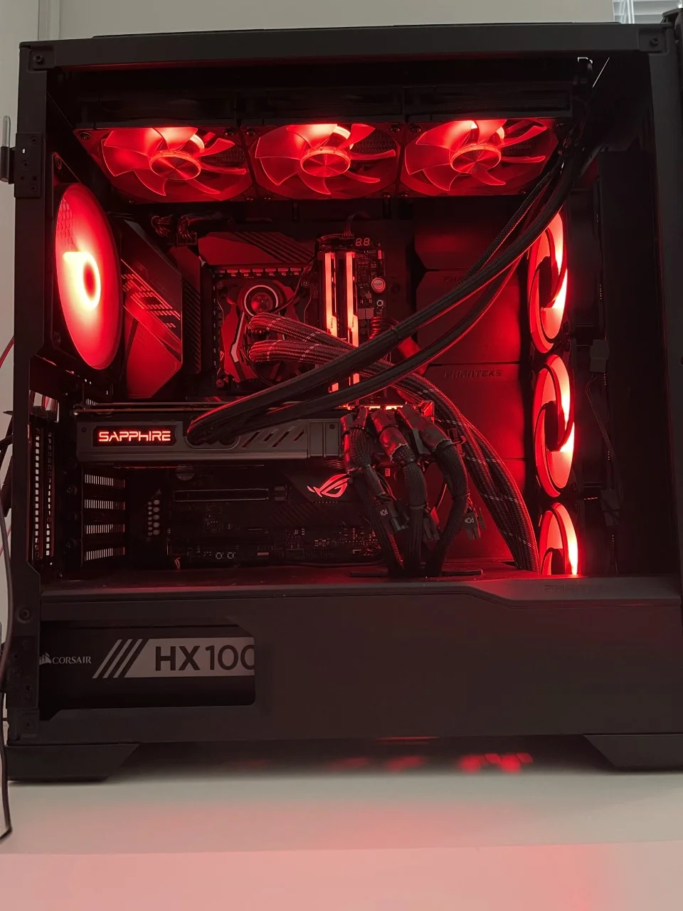

When I got home, the first thing I did was open up my computer and mess around with the cables. I took out the PSU and essentially plugged everything in from scratch again. But my 6900XT requires 3 PCIE cables. I noticed that I had one plugged into the Sata and Peripherals slots. I did a quick google to see if this was an issue and people seemed to be suggesting that it was. So I took that out and instead used 2 cables, with 1 extension from one of those.

May I ask how you have your 6900xt connected? Is it 3xPCIE or 2?

x3 PCI-E connectors required for the Toxic EE 6900 XT. I use three separate, horrible looking cables as I don't trust any form of PSU cable extension. :cry:

I am using extension cables. Maybe I should try without....

First thing I'm going to do is remove the extension cables and see.
Can bad cable management cause issues like this? I have them all twisted and scrunched up in the back of the case out of the way.
