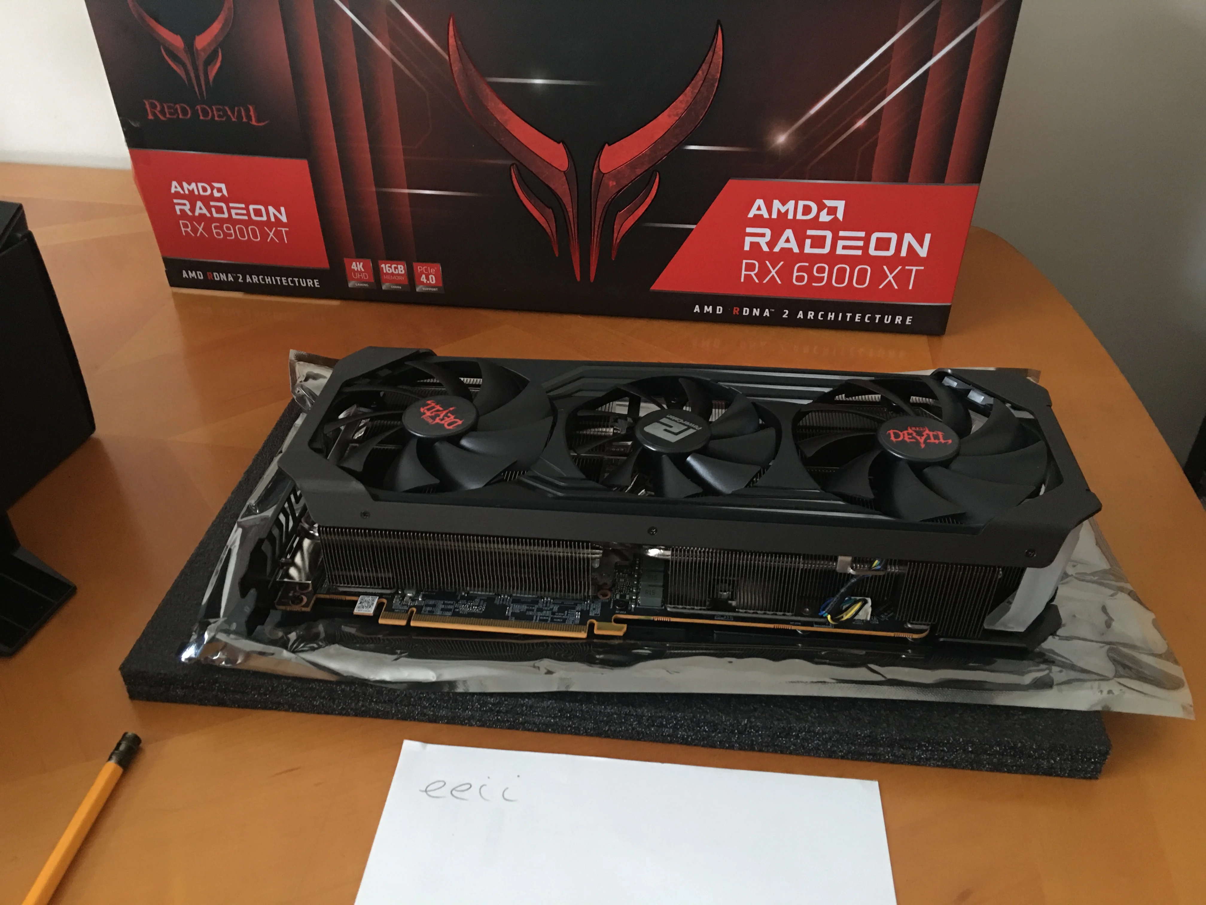

Look what turned up on Saturday.
Had to use a bit of force to push into pcie slot, its a bit tight to say the least. Not helped by my x570 plastic cladding.

Yeah I was shocked that I had to turn my red devil card diagonally to fit it in side to my full tower Phanteks case. I was also concerned that it appeared that it was sitting on top of the bank of 6 sata ports my drives where plugged into at the far right hand side of the mobo. I initially didn't hear the mechanism click when pushing the card down so thought these were stopping it going fully into the Pcie slot. It turned out it was installed fine but not until after I thought I had damaged the bank of sata ports pushing the card down. At the same time as installing the GPU I had installed a second M.2 Nvme drive without realising that this disabled 2 of the 6 ports on my mobo when the second Nvme was installed! There's always a curve ball isn't there!
I had to remove my vega 64 which was in a water loop which took me a bit longer than I thought. At 32cm long and 6cm girth its a whooper :D
