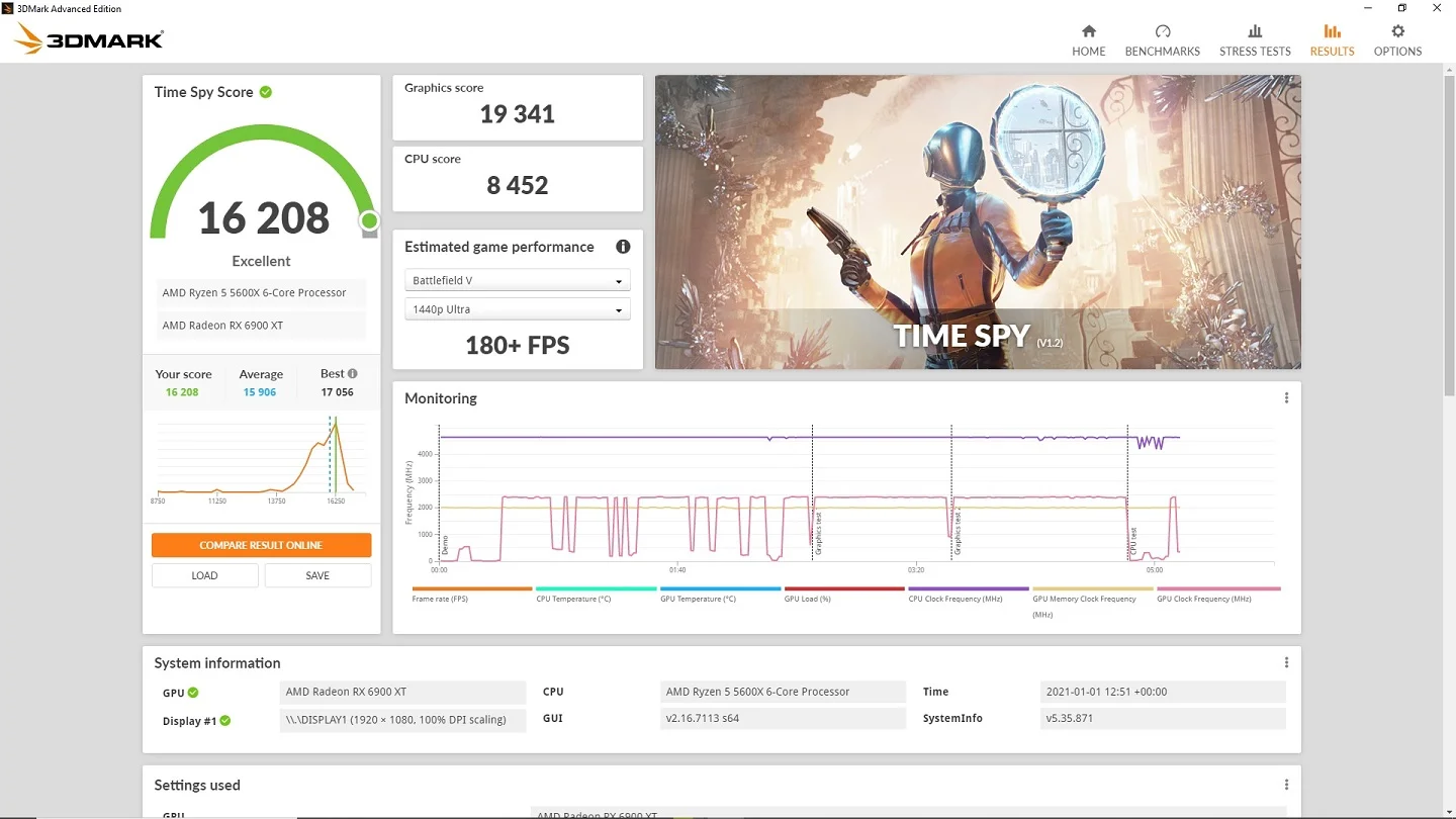

i know time spy and port royal and super position will work. i am just testing time spy now. i bought the ref one, but then i saw someone had a nitro for sale, so i bought that was well. I'll probably end up selling one of them tbh. I just want to get the mega bench numbers while i have 2 as this kind of thing doesnt happen that often :D
Thoughts so far are, the ref card is much heavier and feels way nicer. the nitro is much bigger physically, but its 250g lighter. Its actually quite disappointing tbh. Even the 5700XT nitro is heavier. The nitro has a power limit of 300w when using the +15% whereas the ref card seemed to top out at 280w. I have used more power tool on the ref card though and it can easily pull 380w no problem.
The stock boost on the ref card is 2250 the stock boost on the sapphire card is 2285, in wattman ref says 2484 max and sapphire says 2494 max.

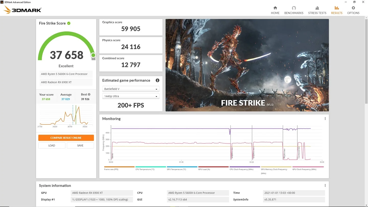

Not ran firestrike or timespy before but this is my score after running firestrike with the settings LtMatt posted
That's a good score, well done. :)
Settings used for previous score
2349 min 2449 max
2012 mem fast timing
power limit 15%
1100mv
same settings but max frequency 2700 produced this, maybe a lot more left in the tank? unsure
Great score, I can’t score this high in this bench but my system under perform in this particular bench.
check out the Firestrike Extreme thread and benchmark as I’ve posted a decent score there.
